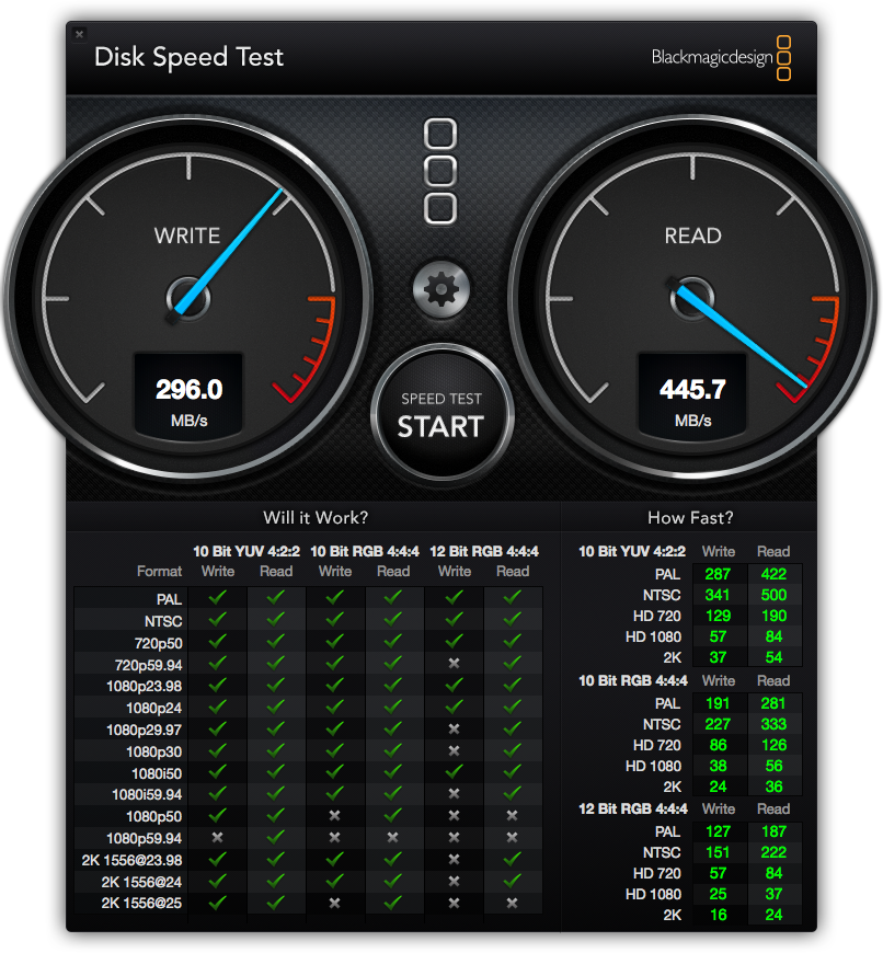

I went back and forth about a Fusion drive when I bought the last revision of the 27" iMac, I finally decided to go with the 3TB Fusion drive, and I'm glad I did, and I would recommend it to anyone.
Here is a screen grab for my 27" iMac 3TB fusion drive.
I've used SSD's in all my Mac's, and wouldn't use anything else, the Fusion drive is perfect though.
