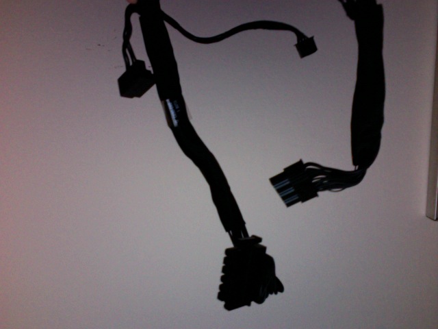

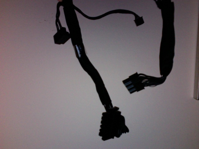

I just received a call from the authorized service provider here in Greece (we don't have an Apple Store) and they mentioned that the problem was a faulty "monitor cable" that got replaced and everything is up and running now.
I should pick it up on Monday.
I am a bit surprised to be honest, since I've been reading a lot about faulty PSUs, motherboard(s) and graphics cards...
edit...
They just called me again, saying that there was a communication error and that it hasn't been fixed yet. They'll let me know...
Just to put an end to this for future reference.
I did actually get my iMac today. That is after 4 working days which isn't that bad considering there is no Apple store here in Greece.
As I mentioned on my previous message, it was a case of a faulty cable (see attached)
It cost me nothing since I wasn't past the 1 year warranty.
