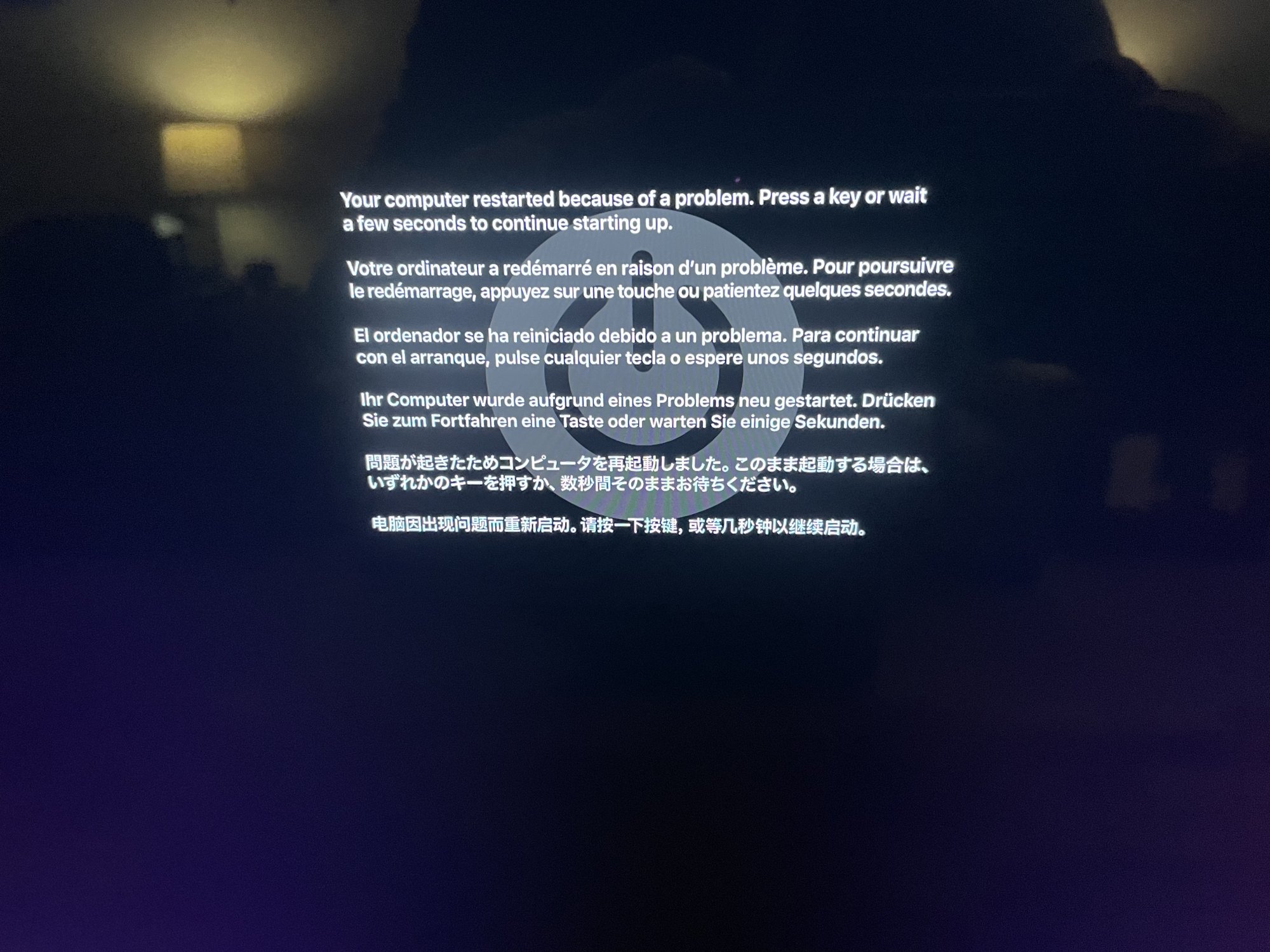

I have not changed anything other than installing 11.3 2020 iMac 27". This week, every time with no exception, when I click on shut down it looks like it is shut down, the screen is black, and then it gives a warning screen and restarts. I thought the first time maybe I hit restart by accident or something. But clearly, about 7 times or so now, when I shut down it ends up restarting. sometimes ill hear the fan make a fast ramp-up for maybe a half-second while the screen is black. I've typed the same thing and submitted every time the submit report to apple dialog pops up.
Any ideas? Thanks.

Your system crashed with a panic during shutdown which forced the reboot.
If you startup in single user mode and then shutdown does it still restart?
I'd try resetting SMC.
  1. Shut down your Mac, then unplug the power cable.
  2. Wait 15 seconds, then plug the power cable back in.
  3. Wait 5 seconds, then press the power button to turn on your Mac.

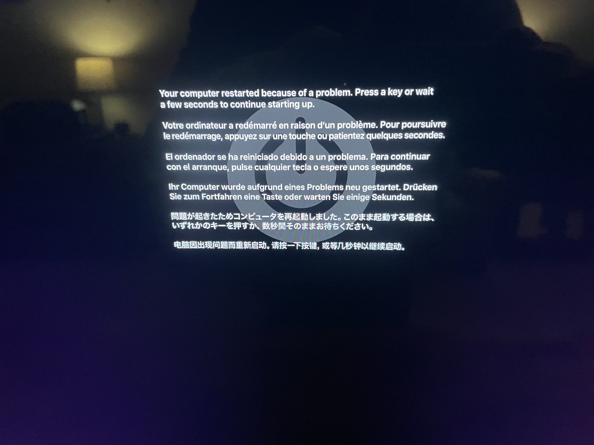

I was getting a similar panic, but the one which hung was different:
panic(cpu 0 caller 0xffffff801e8a2233): "PowerOff timed out in phase 'Notifying power plane drivers'. Total 30000 ms:
PowerOff/Restart still waiting on handler: 3002 ms @ 0x<ptr>, com.apple.driver.AppleThunderboltNHI(7.2.8)[75297F54-C9FE-3CB0-80E6-F8C6E0C89BE9]@0x<ptr>->0x<ptr>
Not sure what device is controlled by IOUSBHostFamily but you have a lot of devices that are getting power off instructions. My suggestion is to disconnect EVERYTHING from your iMac other than your keyboard and try a couple of shutdowns/startups. Sometimes it takes a couple for things to clear. If the problem goes away add things back one by one until you can identify the offending device.
In my case I disconnected all thunderbolt cables and after a couple of shutdowns/restarts the panics went away. Added them back one by one until the offending port was identified (a thunderbolt bridge).
HD Fan, does that mean that one of the devices you had 'went bad' hardware related? in my case it seems like it was a SD card in the slot on the back of the iMac, and it also didn't start until the Big Sur update this past week.
Any ideas? Thanks. View attachment 1768251

I have exactly the same thing. Did you fixed it?
Best i can recall, i ended up taking a SD card out of the back that seemed to be the reason. It started after the OS update if I recall. However, it has still done it on a couple of occasions for no reason i can pin down.
For me, it starts with Big Sur update. And I don’t use sd card slot, the kernel panic is exactly the same. I just can’t shutdown iMa, always restarts with this error..
