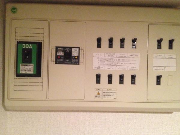

About the breaker, I've no idea if Japanese breakers look completely different from American ones (I grew up in Ireland), but this is the one in my apartment:
728-image.ajpg
