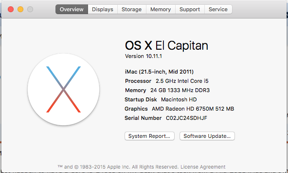

I've got the 2.5GHz i5, 24GB RAM and a 512GB SSD installed and it's pretty fast, but what about the video card? I'm not a gamer, but I do a little iMove and usually have anywhere from 5-20 YouTube tabs open in FireFox.
By the way, it's a Mid-2011 now because I replaced the entire Logic Board.

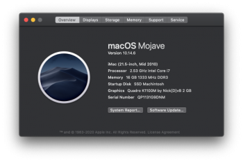

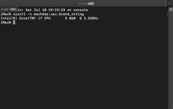

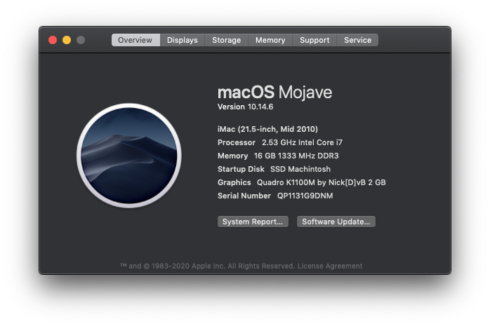

Alright this is an old thread but i would like to say that the i7-860s is compatible with iMac 11,2
well so far i have not gotten any kernel panics from the GPU, and also according to the Intel Spec Sheet for the i7-860s it can only handle 16gb of DDR3, but if you want to upgrade your GPU i recommend reading the 1st page of this Thread
