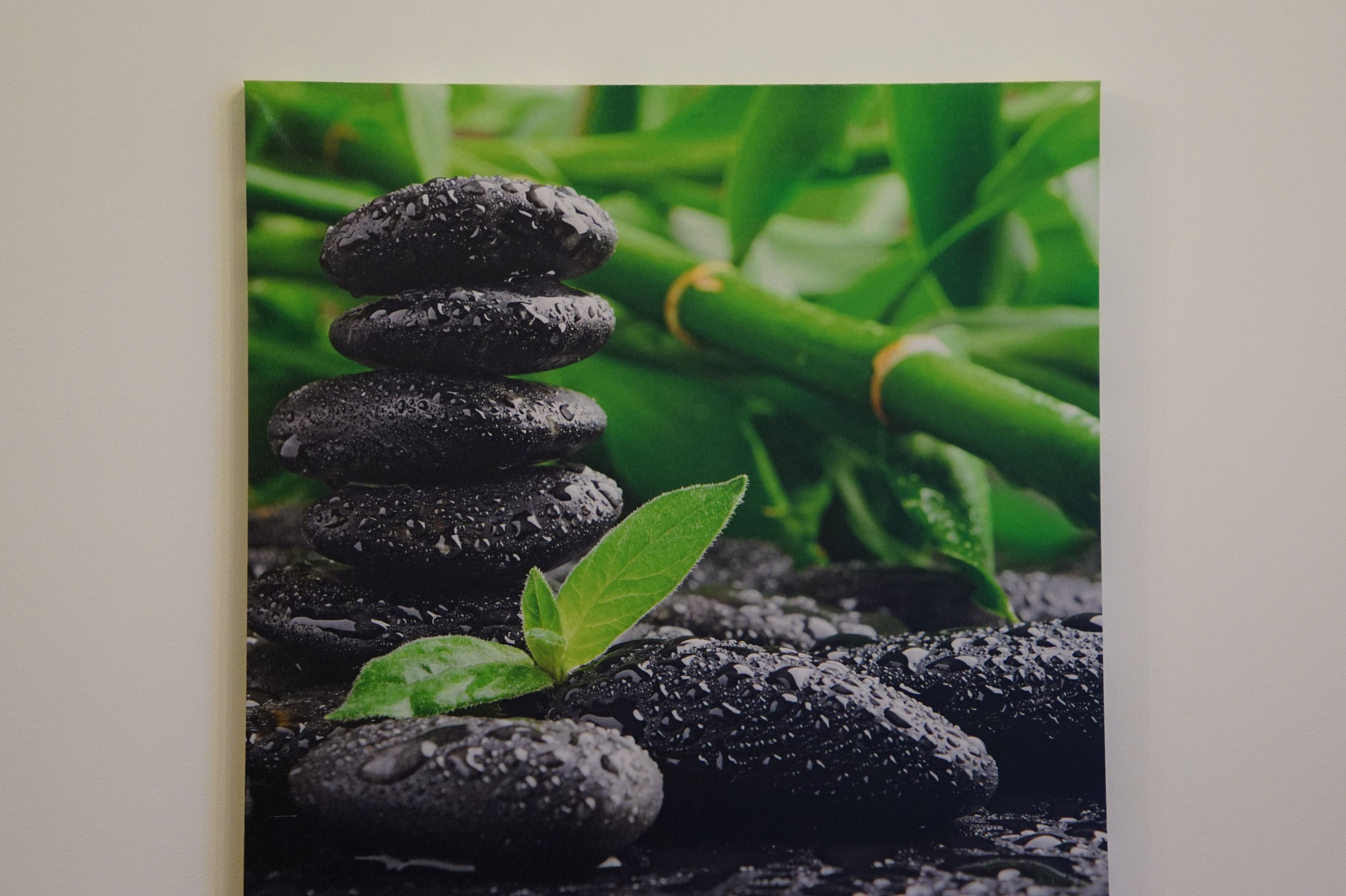

Today I noticed that my Sony SEL18200 produces barrel and pincushion distortion (See the attached image @100mm). Reviews of the lens state that it is "supposed to be like this", respectively it is not a defect of a particular lens but it is as it is for all SEL18200 lenses.
http://www.imaging-resource.com/lenses/sony/e-18-200mm-f3.5-6.3-oss-sel18200/review/
What I was thinking is, however, that the lens compensation settings in camera would take care of this. I thought that the review is done without the compensation settings ( ? )
My question - Is this the reality what I can expect after the in-camera image compensation, or there is something wrong additionally with the specific lens (image compensation is not working - it seems to be enabled).

In-camera conversion is usually the best place to correct for distortion, CA and possibly other lens characteristics, as long as the lens is from the camera manufacturer and/or known to the camera firmware.
There are plug-ins for image processing software that can do a similar job. They usually cost extra, and you have to make sure that whatever you buy supports your camera/lens combinations.
If you use in-camera correction the results should be very obvious when your compare the RAW and JPEG images from the camera, especially with wide-angle lenses. If they're not then something isn't working.

Thanks! Yeah, it most probably will not be noticable in real life outdoors. Still ... is it supposed to be normal that a JPEG looks like this after in-camera image correction and there is some uncorrected geometry?
The slight distortion is caused by the optics,and it's a typical thing that get worse with shorter lenses,all wide angle lenses have more or less distortion. The "unsharp background" seen in the pic,can easily be changed if you adjust aperture setting.
It is a compromise like everything else. This image was probably taken as it was the one that showed the distortion the most - to make a point. Remember the optical correction is a computer algorithm so it isnt infallible. It is a case of "close enough".
The uncorrected geometry if there is some is because you are trying to make a lens group optimised for one focal length give good performance at another and all points in between.

I went to a local shop and the excellent staf gave me a SEL18200LE, and A6000 body. I tested 4x - 2x with 2 lenses on my camera, 2x with both lenses on the A6000. And the result was that there is the same distortion within all 4 images! A bit of difference with LE, but still the same. Also it does not matter whether the image was in RAW or JPEG.
Hmm... I was thinking that a lens which is not a cheap lens, will not have any such problematic aspects. To tell the truth, I like my SEL50F18 much more :) , but sometimes I want to get closer to wildlife as well...

All lenses will show either rectilinear distortion (RD), angular magnification distortion (AMD) or a mix of both. As a lens designer you can only correct for one at the expense of the other, but not for both at the same time.
RD is the familiar pincushion distortion. With AMD all lines in a brick wall image are straight, but the bricks in the centre are larger than those at the edges. Both RD and AMD can be corrected for in software, and with knowledge of the lens characteristics that's exactly what the in-camera conversion does.
In general, lenses with longer focal lengths show less RD/AMD since their image plane is inherently less curved. The compromise between RD and AMD is therefore mostly a problem for designers of wide angle lenses.

The distortion in some lenses is quite complex. While in theory, such distortion can be corrected in software, there is a vastly higher need to make the camera work quickly, be compact, and take a large number of pictures on a single charge. Given the limited processing power of a camera's microprocessor (primarily limited by the need to be have low power demands) and this need to process the image very very quickly, the correction algorithms are "quick and dirty" compromises. They do a very good, but not perfect, job. Generally, they correct only the average barrel/pincushion distortion (which sometimes leaves a "mustache distortion" component uncorrected as seen in iPhone images) and not dealing with any AMD.
Well, that depends on the camera, with DSLRs the image quality is a prime concern. They use custom chips designed to do exactly these kinds of image transformations, based on a bunch of parameters describing the lens characteristics. And yes, they do correct AMD. One of my favourite wide-angle zooms is well corrected for RD but shows AMD. This is not immediately obvious in typical scenes, but when I flick between the raw and JPEG versions of an image it pops out.
