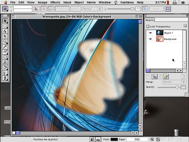

bowens said:
Do you know if this program uses layers?
Corel PHOTO-PAINT does have layers, but it calls them "objects" rather than "layers". Seems to work pretty much the same as in Photoshop from what I can tell.
I use either Photoshop 5.5 or 6 in Mac OS 8/9, so I don't have a lot of experience with the Corel apps. Attached is a screen shot of an image with two layers... original on top and an inverted version below, where I've erased part of the top layer.
