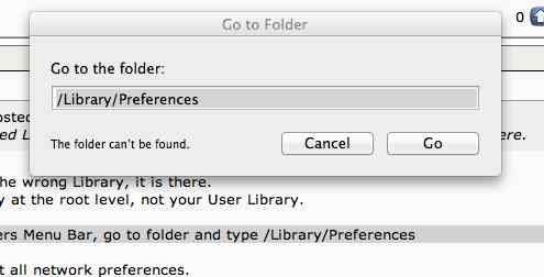

Maybe you got the wrong Library, it is there.
The main Library at the root level, not your User Library.
Click Go in Finders Menu Bar, go to folder and type /Library/Preferences
Edit: It will reset all network preferences.
Folder not found!
And there is no "system configuration"folder to be seen
Folder not found!

Ah, I think I know why, you are French?
If so it is probably a different name, now, I don't know French so you have to figure it out yourself, but believe me, there is a folder like that.
You can also enable invisible files by opening Terminal, then paste the below command:
defaults write com.apple.finder AppleShowAllFiles True
Hit Enter
killall Finder
Hit Enter

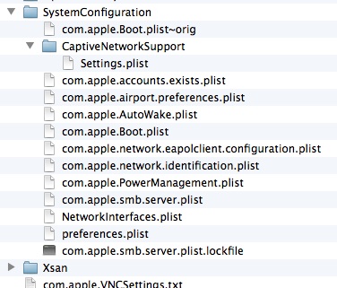

Found it. Macintosh HD/Library/Preferences/SystemConfiguraion
Is the "Next" folder "CaptiveNetworkSupport" and is that the folder I should drag to the desktop then restart?
Sorry to ask s many questions but I want to get it right !
Here's what's in the folder:
The sun went in 🙁
Just move the system configuration folder to the desktop.
