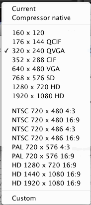

iMovie 08 will export in 720p I do not see why 09 will not. Here are all the options of exports you can do in 08 via QuickTime:

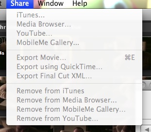

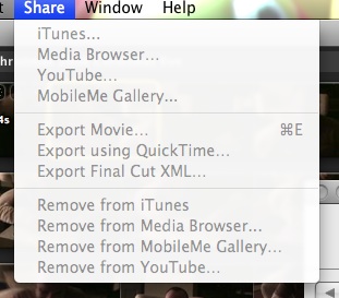

Yep thats clearly wrong. Those are the options from using the pre-set exports (right above the quicktime export) in iMovie.
