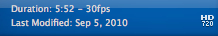

Correct. I just saw this thread and I use 60i and once iMovie does it's thing it ends up being 30fps (see screen shot). I use a Canon HF-S21 and as of now the 30fps 720HD is what I get if I set it up as such. If I wanted to I could then use Toast (or whatever Apple has) to burn to BluRay but it doesn't matter right now for me.
