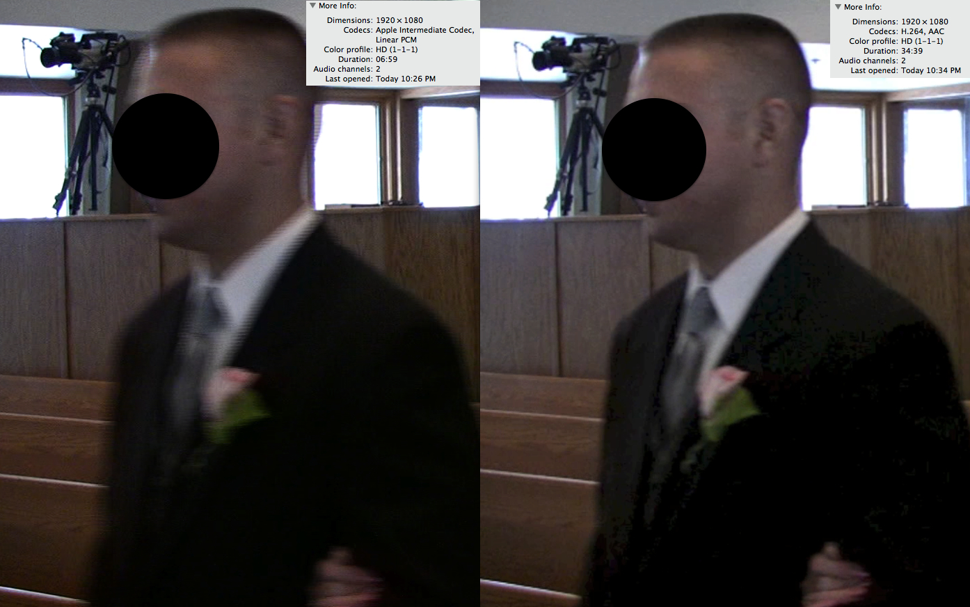

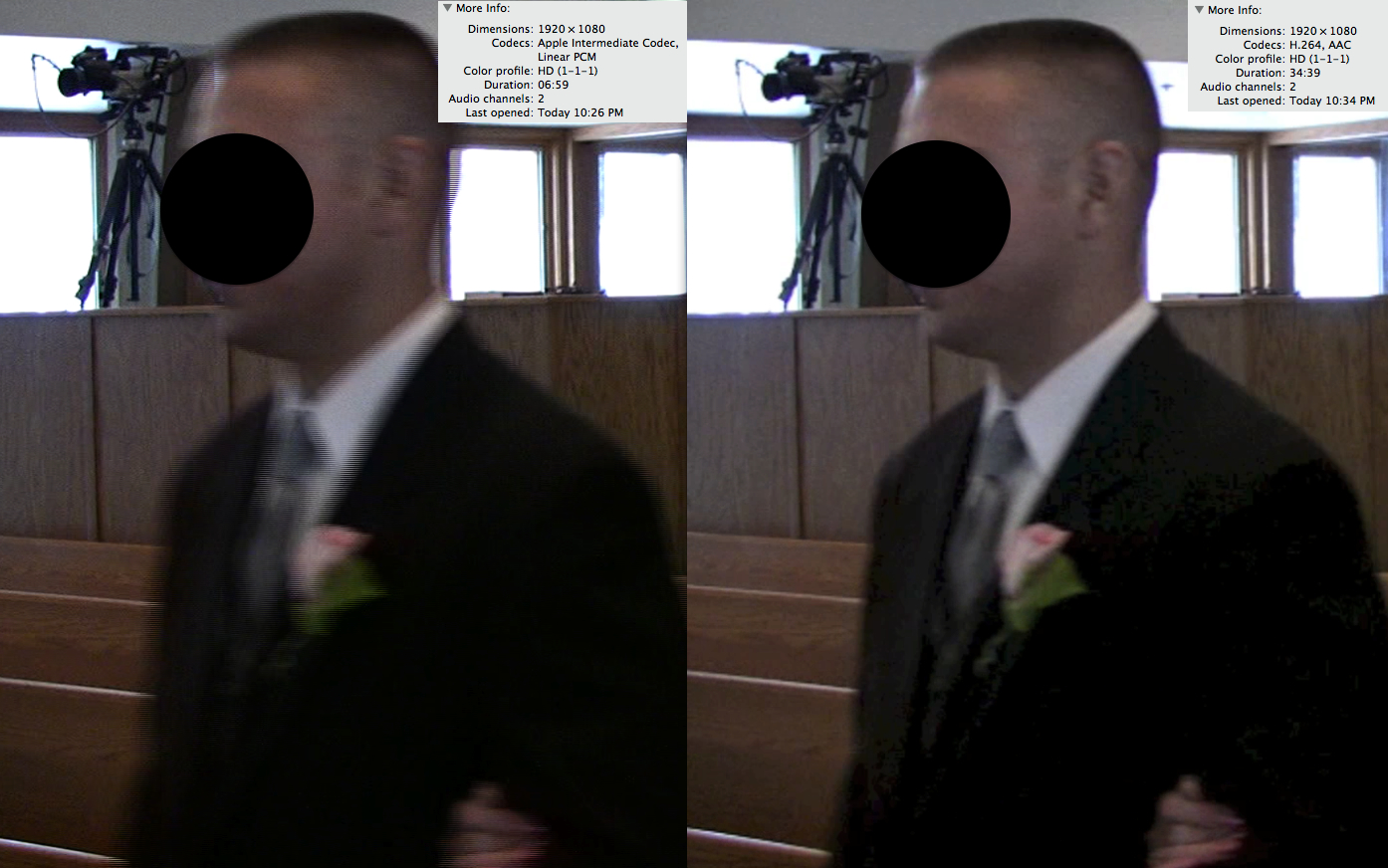

A picture is worth a thousand words. Post before and after pictures.
Originally imported from a Canon HV20 using iMovie '09, full resolution. Imported into iMovie '11 without choosing Optimize. Raw video in the iMovie Events folder looks fine, in the screenshot it's the left. The preview window while editing as well as exporting introduces posterization and a maximum resolution of 960x540. It's on the right. You'll notice the awful artifacting of the dark suit right away. Also see how much clearer the camera in the background is in the raw video, as well as a lack of deinterlacing "blur" on the right. It just discarded one set of fields. Grabbing the Apple pro codecs didn't help, it's still a max resolution of 540p.
Downloaded the FCP X trial and imported the iMovie project. The preview window looks like it should. It's still exporting but I'm expecting it to work correctly.
Absolutely ridiculous. Oh I'll be getting Final Cut but Apple won't be getting 300 bucks from me for something I shouldn't need in the first place. 😡

Was that section shoot with Auto Focus?. Look at the power of your white balance and your bench. Perfect. But your person is not.
It is a difficult shoot to get correct if one has little time. Try using the sharpen tool in FCP-X and play around.🙂
Thanks for the tip but that's not my concern right now 🙂 I'm no pro, this is a friend's wedding. I was using auto focus but the person in this screen is blurry from motion, not focus.
