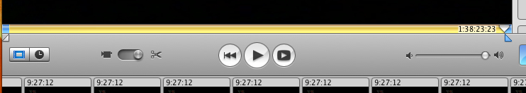

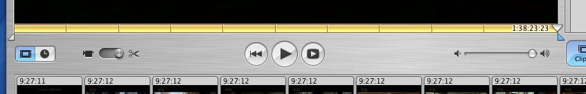

Hi,
I noticed that both iMovie3 and HD5 do show me the whole movie in the cropping bar. But when I do it in iMovieHD6 with the same movie the bars can only be moved to some certain point (look at picture) and if I let it play it will not play the end of the last clip, though the total time of the movie as well as the clip is displayed the same length.
see pictures. (I did not snapshot the preview window area itself, but if I move the "arrow" to the end I will also see a different end picture in 5 vs 6.

Looking from your pictures the right hand side has the cropping tool in use. Both edges at beginning and end are blue which is telling iMovie only to play the yellow part.
I may be incorrect as i have not used iMovie for a while. At present i have iMovie11 as a software.😉
Thanks for trying to help, but what does that mean "cropping tool"? If I want to crop I place the slider where I want it and press "cut on position" (or what it is called in english), but the slider can't be moved further into the blue part. That is the problem!

Thank you very much! But you do not understadn the problem.
I know about cropping and I DO NOT WANT TO CROP ANYTHING!!!
I want to just set the marker at the beginning and at the end, to be able to view the whole content. As it is now, the Movie starts not at time 0, but something later.
I can not push the marker left to the 0 position!!! I also did not crop anything before.
I just opened the file I recorded with iMovie 5 in iMovie 6 and iMovie 6 decides to think that the beginnign of the movie is not at 0second, but somewhere later AND that the end is not after the fade out and all credits, but somewhere before the fade out.
Yes, I did select all footage I want to play, so that is not the reason!
Yes, I thought one can read that from post 1, but you have to excuse my bad English, I am European and so the word order and grammar might be misleading.

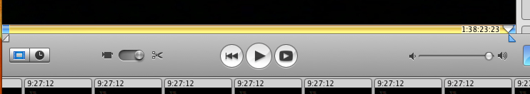

Cox Orange, I do not think that you have a problem. I have a video, when I play it in Quicktime, you can see that it is 33 seconds long:
Here it is in iMovie6HD, with another clip, and you can see the Crop Markers.
You can see that the time counter is at Zero in the Timeline and at the Crop Marker. In the Timeline, you can see that the Playhead is at the beginning of the Clip.
Here you can see the Playhead is at the end of the Clip. The time is 33 seconds in the Timeline and at the Clip Marker.
Here you can see the Playhead at the start of the second clip. The time is the same in the Timeline and at the Crop Marker.
Here, you can see the Playhead at the end of the second clip. You can see that the time at the Playhead which you can see is at the end of the second clip, is the same as the time at the Crop Marker.
Here you can see the Playhead at the end of the second Clip without use the Crop Markers. The times are still the same
Finally, you can see that this time is the same time as the total Project, apart from 0.01 seconds:
You are not missing any of your video.

I did try it again with another video (captured with iMovie5) and it is like you said. Unfortunately I do not have the one, that I have the problems with at hand, have to dig through my HDDs, it was captured with iMovie3, so maybe that is the reason, but I remember clearly that I could not scroll to the names of the actors at the end. But its ok for now.

I found the answer to my problem.
Case A:
- captured in iMovie3
- open in iMovieHD-6: put the clips in the bottom time line. playing the last clip to the end is not possible. Now, I elect just the one last clip, same result. Now I put that back to the scrap area and here I can play it till the end. As soon as I put the last clip in the bottom time line, it will not be played till the end again.
Case B:
- captured in iMovieHD-5
- open in iMovieHD-6: no problem
Case A is, why I had the problem, when I initially posted. Case B ist, why I did not have the problem trying it again, after Dave showing me he had no problems.
So, not to make a generalisation, one could say, material from iMovie3 makes problems under iMovieHD-6 (by the way the iM-3 stuff is perfectly playable in iM-HD-5).
