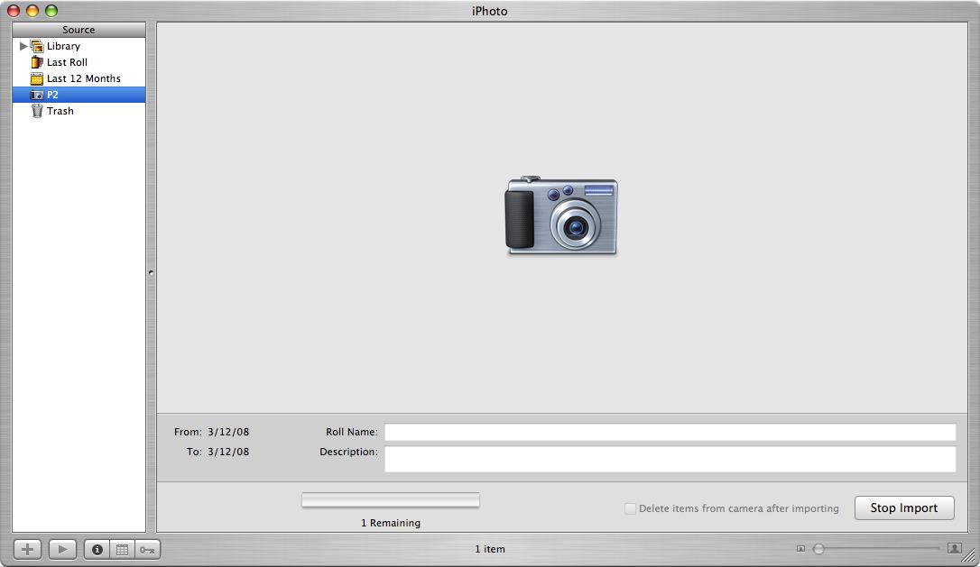

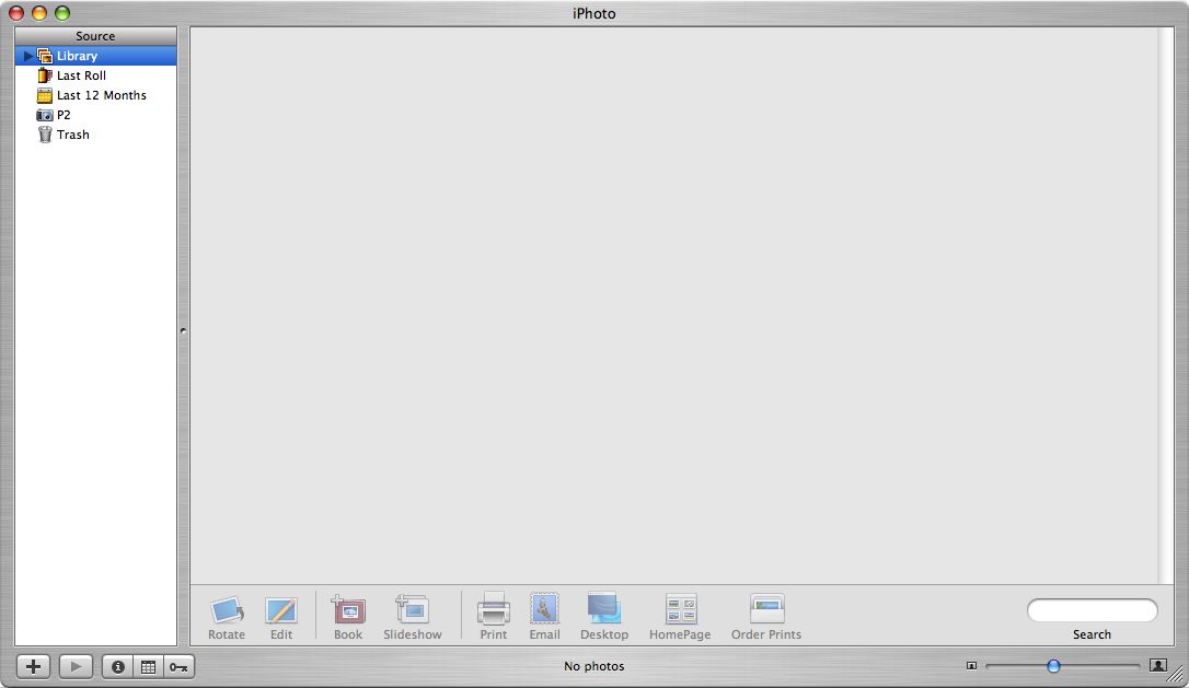

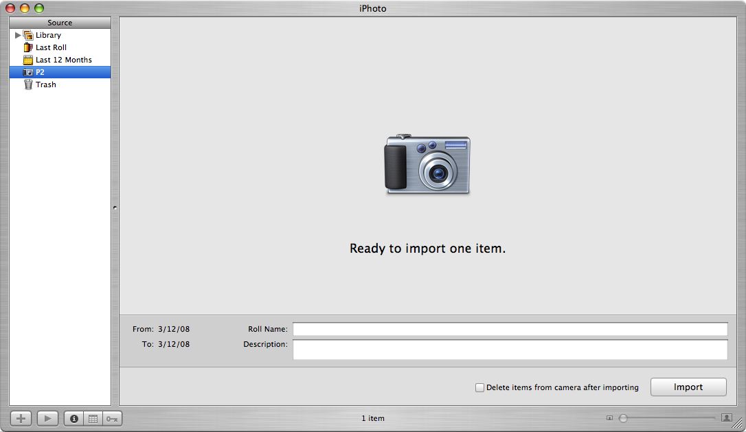

I've got a 14 minute video recorded on a Coolpix P2. When I plug the camera into the USB port, iPhoto immediately launches and sees the camera just fine; however, iMovie doesn't see the camera.
The PowerBook owners manual mentions loading videos to iMovie via a Firewire cable, but the camera only has one USB port and came with a USB cable.

The work around is to put the camera in "storage device mode". This way the camera will "loolk" like a thumb drive to the Mac. Then you drage the files off the camera.
Buying a card reader would do the same thing.
My guess is that your camera records video in a format iPhoto does not recognize as being video.

Doesn't your movie appear in iPhoto? It should...

iMovie only works with Video Cameras. Still cameras with video features are treated like still cameras, and all photos and videos (which are files, not true video from a video camera) are imported into your photo software of choice. Once you find it in iPhoto, just drag it out and to to it what you want.
You won't be able to import the video into iMovie, until you convert it to a DV stream in QuickTime (or another converter), if that is what you want to do.

You didn't mention which version of iMovie you were using, I suspect it's v6 since you are running Panther. iMovie 6 doesn't directly support USB video cameras, you will need to mount the camera as a disc, copy the files off the camera and then manually import them into iMovie.
See here and here for more info.
