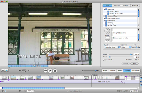

See the column of 3 checkboxes on the bottom right?
Make sure they're all checked. They control audio playback for each track.
