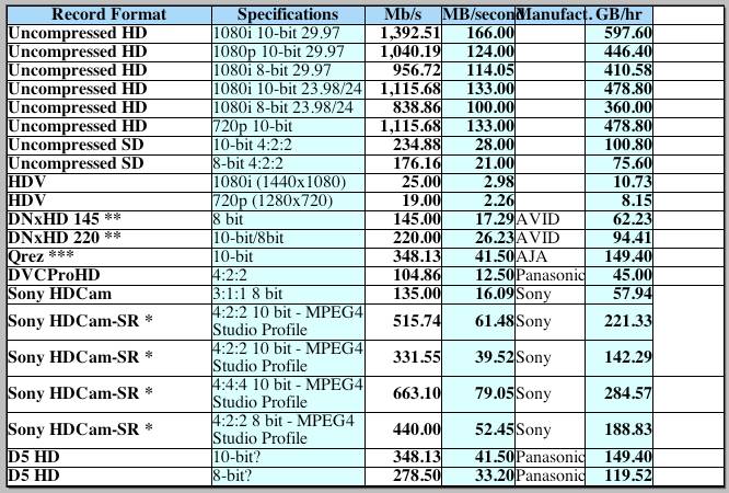

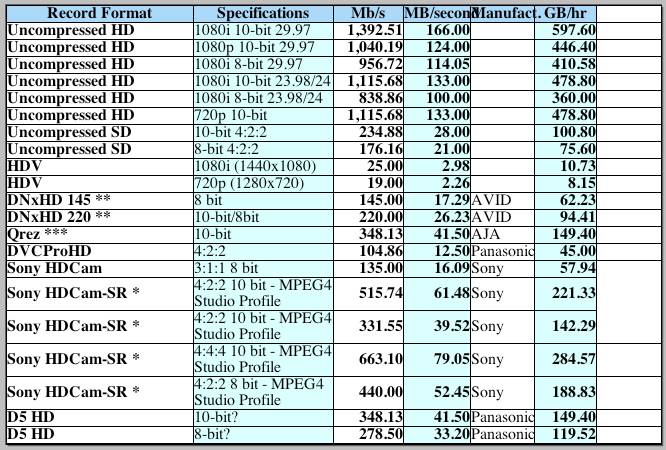

A long time ago, I came across the following chart showing different capture & encoding methods and the relative GB per hour. I can't remember where it came from, so can't give credit. Nor can I vouch for it's accuracy, but it's scary to see some of the uncompressed HD rates 🙁
