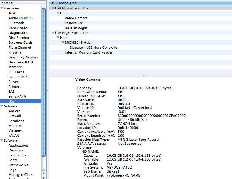

With it connected does it show up in System Profiler or Image Capture?
It looks like the camera shows up in system profiler. Also, the SD card shows up on the desktop when the camera is connected via usb. Only thing that will not work is imovie import. See screen shot of system profiler below.

Aarlive, hopefully you have this issue sorted out by now. I was having the same problem and finally resolved it last night. I installed the Pixela image mixer application on the Windows partition on my iMac (I am fairly certain that there is also a Mac version but I think I lost the discs), transferred all of the video from the camera and formatted (initialized) the SD card on the camera. Next, I transferred the movies back to the camera, booted into the Mac OS, plugged in the camera and the camera was properly detected by iMovie and the movies all available for transfer.
