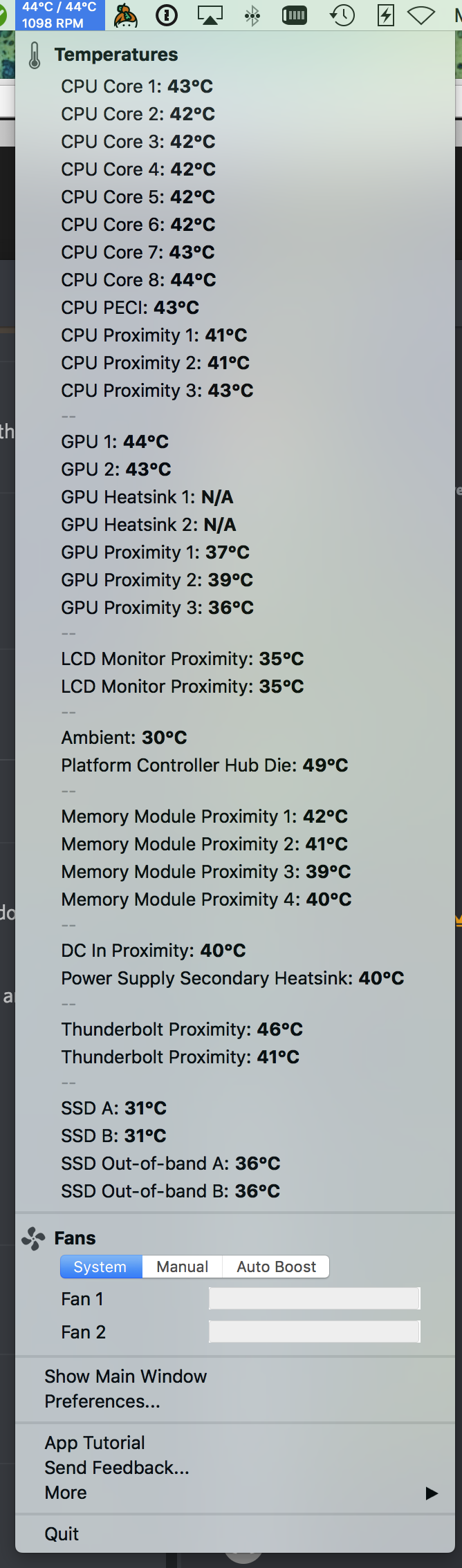

TG Pro has been updated to work with the iMac Pro. I use it just out of curiosity about fan speeds and component temperatures, with standard system fan control (not using their custom controls) https://www.tunabellysoftware.com/tgpro/
Didn't know about that one, thanks. However, we already have iStat Menus and Macs Fan Control for iMac Pro running OSX. What we need is something that works in Windows/Bootcamp. If anyone knows of something, please let us know.

Thanks for letting everyone know about TG Pro and iMac Pro compatibility! We recently updated the app to be compatible with the new beast and we're able to show the temperature sensors, fan rpm and allow boosting of the fan speeds as well. If anyone is interested in trying it out, there's a free trial at the link.
