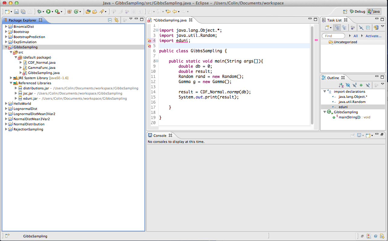

Would the screenshot below help?
I am using Eclipse (Ver. Helios Service Release 2)
I right clicked GibbsSampling > Java Build Path > Add External JARs, does that sound like the normal procedure?
I've also tried, import eduni.*;
which the screenshot doesn't show.

I think I figured it out, the files should be located under "/SRC" NOT under "/Referenced Libraries".
And then, add External Jars. Won't work if it's "/Referenced Libraries".
I usually put external jars in a "lib" folder and then add them to the build path. The "/Referenced Libraries" you refer to is not the location of the jars but just that your project is using them.

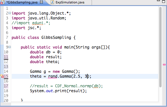

I want to generate numbers from gamma(shape=2.5, scale=0.5).
I have this:
double theta;
theta = rand.Gamma(2.5, 3);
I get "rand cannot be resolved", how should I use it? Unlike R, there are no reproducible examples.
Screenshot has the codes.
"rand" is a variable name that you have never declared. You need to declare it, just like "theta" before you can call methods on it.
Edit: I don't think you want to use "rand" rather "g" on line 15.
Edit #2: I keep looking at this and thinking about ways to explain it without just giving you the answer but...
"g" is of type Gamma and the class Gamma has methods. I don't know what methods Gamma has but you are probably looking for something like

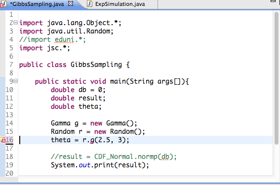

So, I wrote:
Gamma g = new Gamma();
Random r = new Random();
theta = r.g(2.5, 3);
error: in the last line, under g
"The method g(double, int) is undefined for the type Random"
When you have an instance of a class stored in a variable, in this case "g", and you want to use methods for that class, you use "g.methodName()" where methodName is the method you want to use.
In the case of the Gamma class, it has 1 method called "sample" which returns a random number so you would call "g.sample()" to use that method.
I don't know why you think you have to use the Random class. 😕

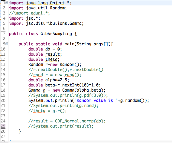

exactly, like you said! To generate random I should use
Code:
g.random()
And I don't need to declare random like how I do in import java.util.Random;
So, it should be
Code:
double alpha=2.5;
	    double beta=r.nextInt(10)*1.0;
	    Gamma g = new Gamma(alpha,beta);
	    System.out.println("Random value is "+g.random());
Also, you have to type
import jsc.distributions.Gamma;
import jsc.*; won't call Gamma out.
I don't know why, but I worked my way through. A screenshot for anyone else ever Googles here. This should help you!
