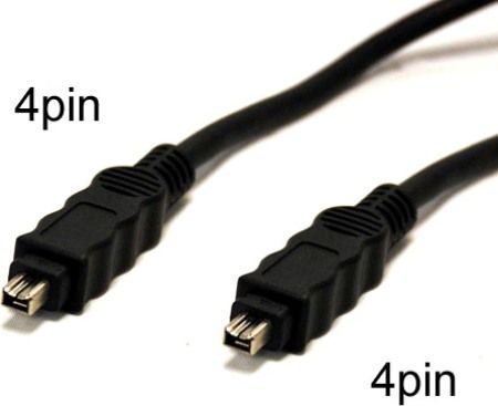

I think it's probably the USB bit that's causing the problem. Normally, the only way to import from a miniDV camcorder to iMovie is by using a Firewire connection. Your camcorder should have Firewire socket that will take a 4 pin FW cable.
(see attached picture)
Connect that cable to the Thunderbolt port and it should work.

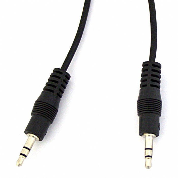

The Quicktime recorder info helped, but I'm still having audio issues. What's the cable that you used to plug the camera mic into the computer? I'm pulling video from a friend's MiniDV recorder, and it seems their AV cable doesn't even go to this camera, it only has the male white and yellow cables and on the other end, the connection is smaller than a normal mic plug. I'm going to have to see if I can find a proper cable somewhere unless someone has another suggestion. Thank you!
Hi the audio cable I used was a normal 3.5 mm male to male audio, available in any Fry's or Tesco supermarket, from the headphone jack of my cam to the mac.
More info on the audio jack and possible differences: https://en.wikipedia.org/wiki/Phone_connector_(audio) and look for 3.5 mm.
At the end of the day I went for another solution as I realised that I did not need the raw bitstream from the DV filling up my disks. I now tap out the signal over Super-VHS (which includes audio) and convert them using a Terratec G1 video capture unit, which connects nicely over USB and has a lower bit rate, 1 hour is 3-4 gigabytes instead of hundreds. I want the action, the talk and the people not crisp scenery as it turns out.
I am facing a lag in audio though, of around 0.25 seconds which is a bit of a problem, as lip sync is suffering. Will post here if I figure it out. Could well be the capture unit.
Thanks for the quick response! I dug around my cables at home and found this one that seems to work ok, just plugged the red cable into the mic port on the camera and the yellow into the AV plug, then the mic plug (black end) into the computer and changed my settings in Quicktime to recognize it (in case anyone else comes across this). Works ok as far as I can tell, but what I'm capturing won't rely heavily on the audio either thankfully.

Oh, check :
  1. with a pair of headphones, are you getting audio from the headphone jack
  2. if yes, check the other end, did you put the jack in the correct input on your mac, line in
  3. if no,
    • then the headphone jack is toast, or
    • the cam settings are worth checking (headphone volume, check the cam onboard menu) or
    • the cable you have is not of the right kind, could be too short or not audio, check the wiki link I included above.
BTW the audio lag problem is present only on one recording out of 5 so far so have some checking to do.
