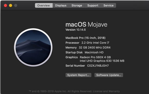

I have an SSD drive on my MacBook Pro 2018 and I have had this and other problems trying to install ANY version of Windows 10 under Mojave. I have even managed to get the Win10 install started, and when install gets to the first windows reboot it can't reset the Mac's boot preferences and aborts the install... so I am not sure an SSD will help anything. I had installed it under Maverick and had successfully kept it when updating to High Sierra and Mojave. Until Apple gets around to fixing this mess, I think maybe the best work around is to go back to a version of MacOS that allows a successful install and then update the MacOS. I am going to resort to this strategy myself for my current setup, I hope this is helpful to others.
Update:
I was able to successfully install Windows 10 pro using a hybrid method. This is what worked for me...
1. Download the "Windows Support" software.
2. Create a bootable Windows install USB (Use an 8GB stick). Add the Windows Support folder to the USB.
Eject the USB, do not leave plugged in!
3. Run Bootcamp assistant to create the partition for bootcamp using an ISO of Windows on the APFS partition.
4. CRITICAL: When Bootcamp assistant initializes the reboot to install Windows interrupt the reboot by holding
down the option key.
5. When the boot options come up, insert the Windows installer USB. When it's image appears, select it and boot.
6. DO NOT reformat the NTFS partition created by Bootcamp assistant, just proceed to the Windows install.
7. When Windows install can't find the SSD drive: (you may need to use the "virtual keyboard" for this)
Select the Apple SSD driver from the Bootcamp folder in the windows support folder and install the driver.
8. Proceed with the Windows install.
9. For me, Windows install completed, I then went to the Windows Support/Bootcamp folder and ran Setup to
install the rest of the Bootcamp drivers and software.
10. Delete the OS/X reserved partition when done.
PS. You may also need to use a wired mouse to complete this install method, I did.
I don't think I left out any steps, good luck people!
