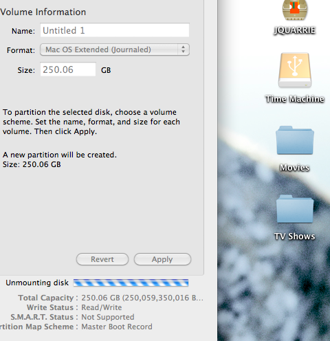

Please see attached image:
shows disk utility failing to unmount - and the "time machine" partition faded out slightly. Force quitting causes finder to crash and error code: -10803 (or one very similar)
Manipulating files on the device however works perfectly normally - apart from time machine

Nope no change. Appears on desktop and refuses to unmount either via dragging or disk utility.
When trying to verify the disk, one partition shows all is ok - however the second partition (which has been used for time machine backups) refuses to verify. Infact it caused my entire mac to crash :S
- The time machine partition is also fine with adding and deleting files.
- thus i would say its something to do with my time machine partition - if only there was a way to factory reset a harddrive or something 🙁
picture attached of the faded icons and disk utility refusing to verify/repair/repartition/unmount

Okay, I think we're getting somewhere now. The faded icons, I've only ever seen this kind of thing like say when you're using a file off of external media and it get's dismounted while you're using it. Like when I've done file sharing with another Mac and lost the network connection the shared file(s) or hard drive will be dimmed on the Mac that was on the receiving end. Hope this makes sense.
If you've noticed my sig you'll see I'm using an older iMac with an older version of OS X so I may be wrong about some of what follows but I don't believe so. It's my understanding that hard drives for use with Intel Macs should have a GUID partition scheme. If they're for use with a PowerPC Mac like mine they should have a APM (Apple Partition Map) partition scheme. Your screen shot shows a MBR (Master Boot Record) partition scheme. I don't think it should be.
Here are a couple of Apple articles concerning MBR that will shed a little light on it:
:apple: Mac OS X 10.5: About resizing disk partitions
:apple: Mac OS X 10.5: Time Machine stops backing up to external disk
I think that helps explain a bit about what is going on, but ultimately to fix it I think you're going to have to reformat the entire hard drive.
