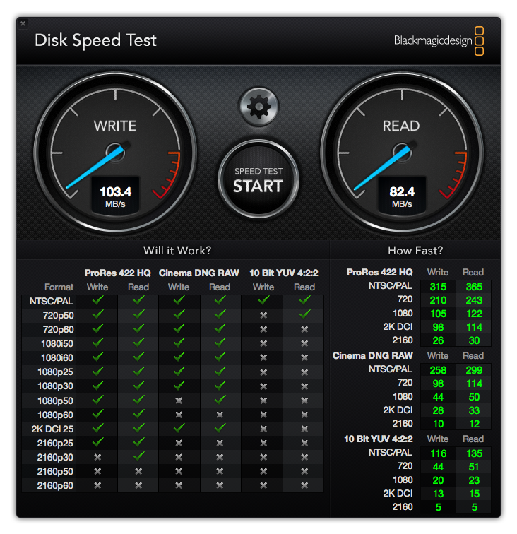

right call me thick but I can't understand how disk speed test works as (on mine) it never stops, the amount just goes up and down whilst the start button is red. I left it running for hours as I went back to work and came in and they are still going up and down.
yeah, it keeps on going. Is it fluctuating wildly?If not, report the values (or screenshot it).
yes it bounces up and down from 0 to 900mb and I couldn't state an average as its so up and down.
[doublepost=1528844674][/doublepost]the first time the write went as high as 845mb but sat at 519mb when it started the read, which went up to 1049 but dropped to 683 and sat there.

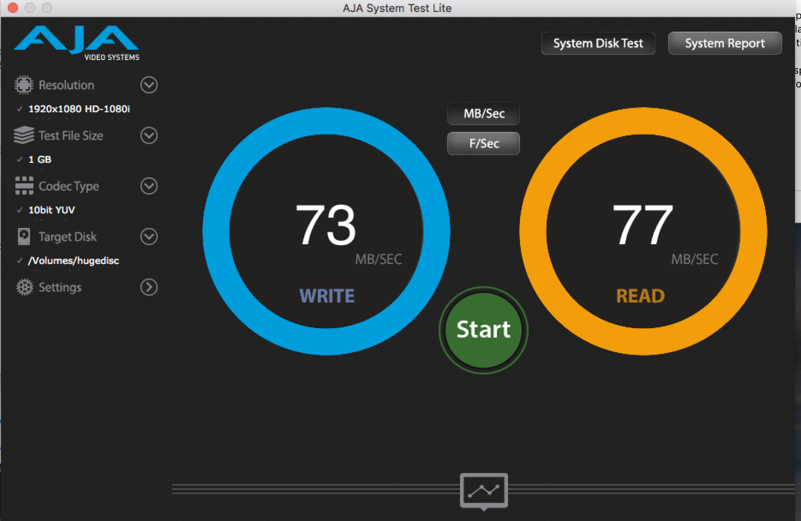

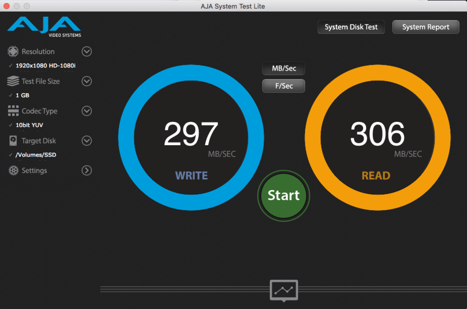

now im really confused. bought the apple thunderbolt 3 to 2 adaptor. the SSD seems really slow.
[doublepost=1528994568][/doublepost]from another app thanks to hobowankenobi
the best app for me seems to be Aja system test lite. black magic bounces up and down. helios wouldn't run on the startup disk.
Fusion drive
thunderbolt SSD
bootcamp (using the windows version of the app)
USB 3 external HD
[doublepost=1529008881][/doublepost]so using thunderbolt and the adaptor, the SSD is actually slower overall than bootcamp using the non HD part of the fusion drive, and not a lot more than the usb 3 4tb hard drive.
Wow, that's quite a hit.

agreed. the problem isn't the fast fusion drive numbers, its the slow SSD numbers.

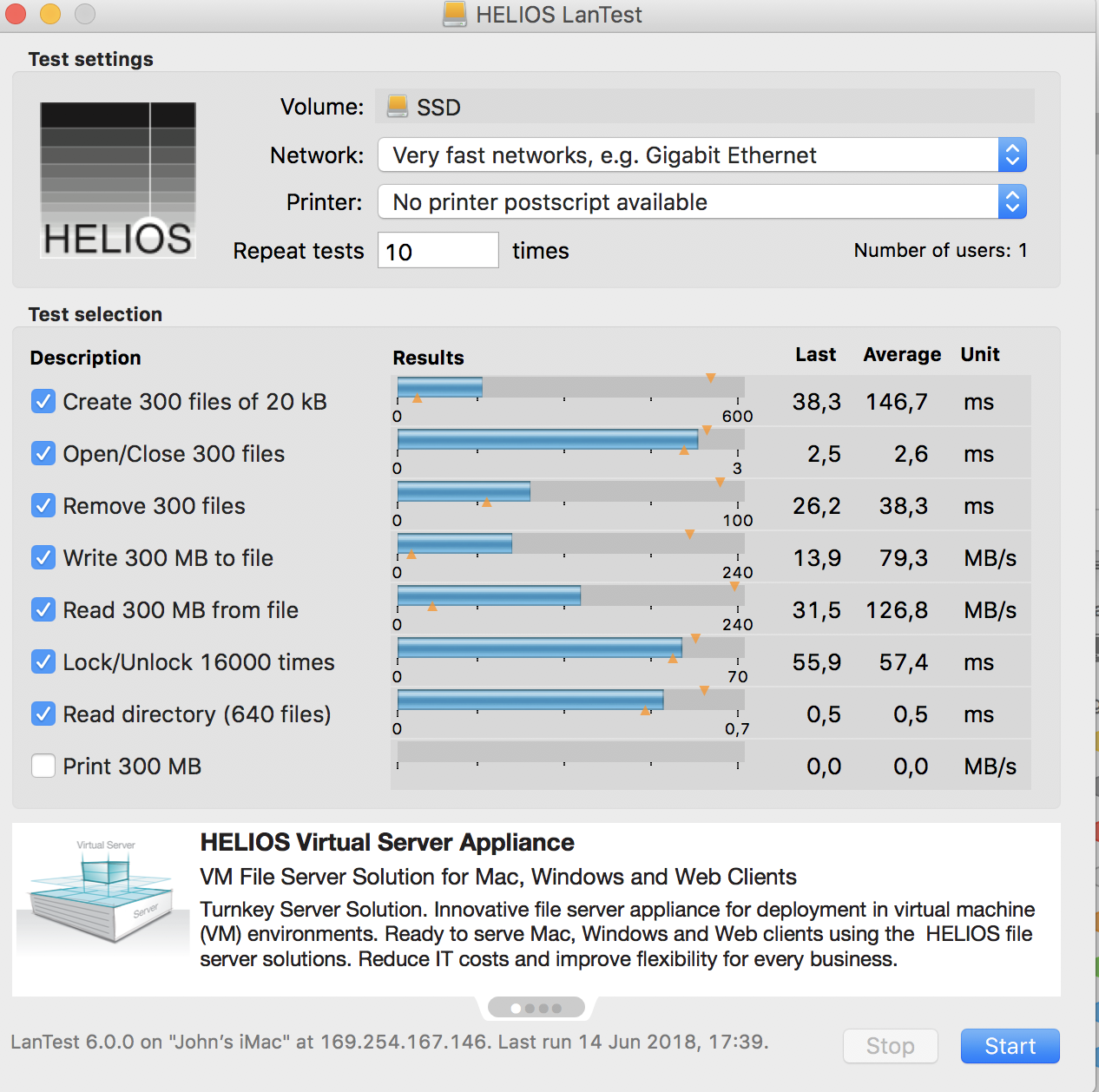

the SSD is silicon Power 240gb Thunderbolt T11, which I didn't test speed wise, but which made my 2011 iMac feel like a new machine.
but then the adaptor is apple, so it shouldn't be slower than what an original thunderbolt port was.
That is odd. But seems like more reasonable numbers.
Even with those, which seems a bit low my modern SSD standards, don't forget that is no seek time and no file fragmentation issues, so typically SSDs "feel" faster than they bench.
BTW, you should be able to run Helios on the internal drive. I have perhaps a hundred times on both HD and SSD....though never on a FD.
That is because sense you ran the test before your Mac cached the first test and added onto it! So always take the first test as the better tests!
that doesn't make sense though, surely. if that was the case then the writers of AJA would either run a script to delete the cache, or have a warning that once you run their app once on a machine theres no point in EVER running it again.
my machine has been restarted at least twice since those first scores.
plus on thinking about it, I ran it a couple of times on the same day as the first score and they were all similarly low.
