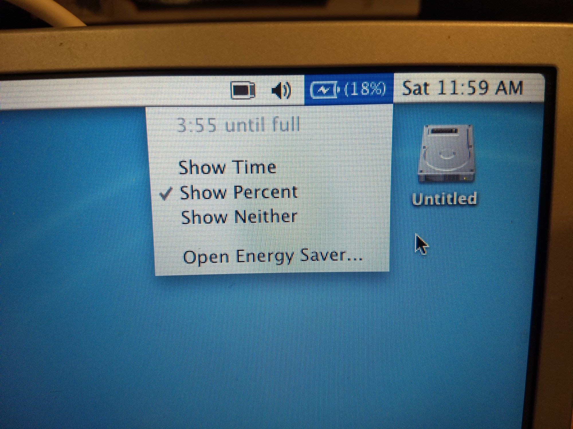

Color me...shocked!! 😵 Never heard of this trick before, or if I had, I'd forgotten about it. But darned if it doesn't work!
I just gave it a shot on a TiBook, with this battery, which as you can see is 18 years old (!!!) - and it's now charging.
Well done, @skinniezinho 👏👏👏
