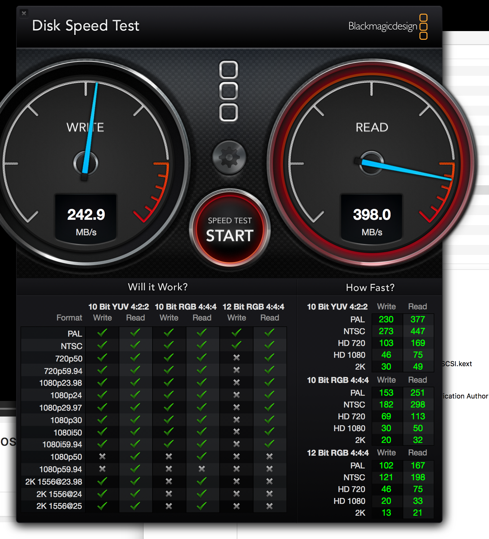

Sorry to bring back a dead thread but I am unable to get my device to show as loaded IOUSBAttachedSCSI however I appear to be getting full speeds from the SSD drive enclosed as shown in the screenshot.
Is it possible later OSX version no longer needs to differentiate between the two?

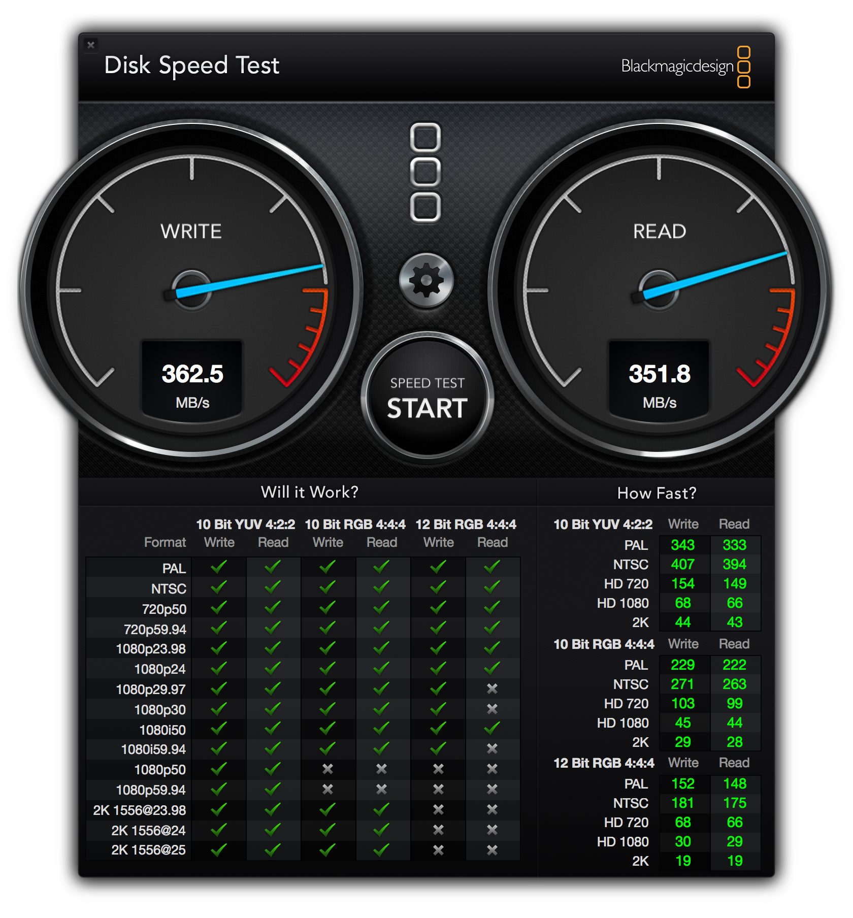

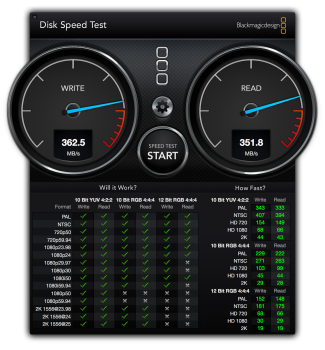

On my late 2013 Mac Pro, this is the output I get:
IOUSBMassStorageUASDriver <class IORegistryEntry:IOService:IOSCSIProtocolInterface:IOSCSIProtocolServices:IOUSBMassStorageUASDriver, id 0x100008786, registered, matched, active, busy 0 (516 ms), retain 9>
Though, with an Innateck FE2009 mSATA enclosure fitted with a Samsung 850 EVO, the speedtest isn’t up to snuff.

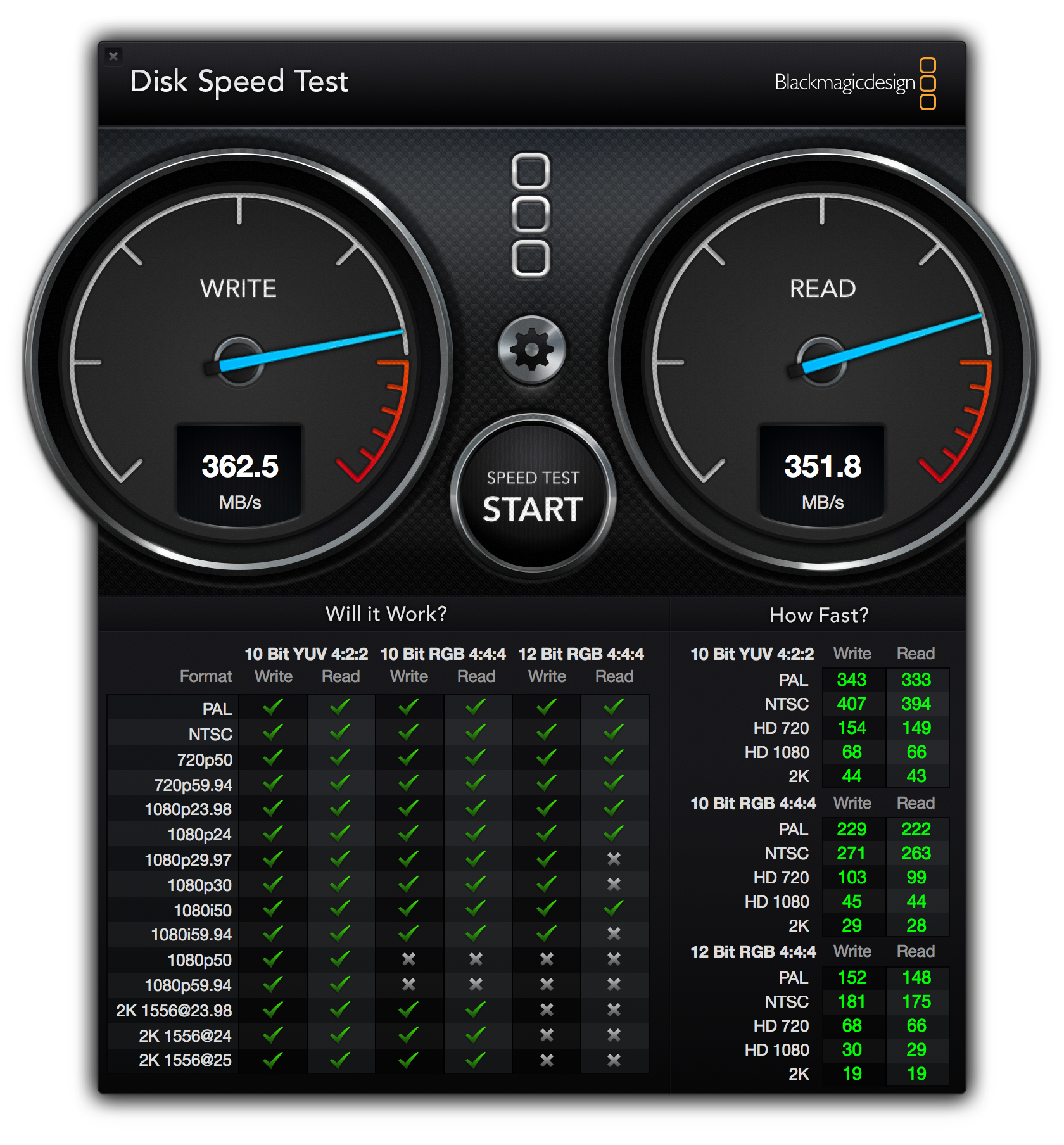

(I had odd results like USB 2.0 speed depending on the port I plugged it in, now it’s on the back on the second port)
What could be wrong?

Yes, it is active. Otherwise you would see something like SATA II speeds (200-300 MByte/s). AFAIK, the enclosure uses the latest ASMedia ASM1153e chip, which is one of the best bridge chips on the market, with perfect power management under OS X and excellent read/write speeds (Windows, Linux and OS X 10.8+).
362mbps writes are very good for a USB3 enclosure.
The 351mbps read speed is ok, but not the absolute fastest.
I get 430mbps reads using either a plugable.com "lay-flat" USB3/SATA dock, or a UCTech USB3/SATA "dongle" adapter.
TRIM -DOES NOT- seem to be a factor here (as was mentioned above) ...

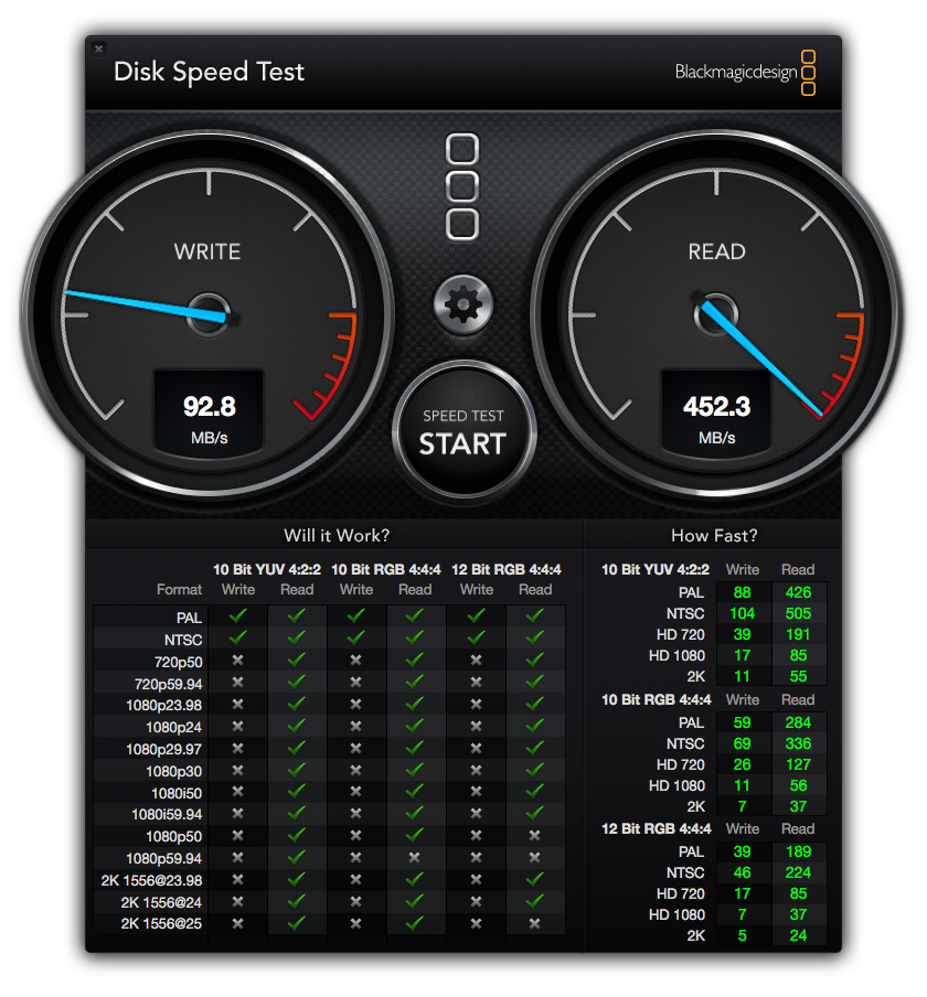

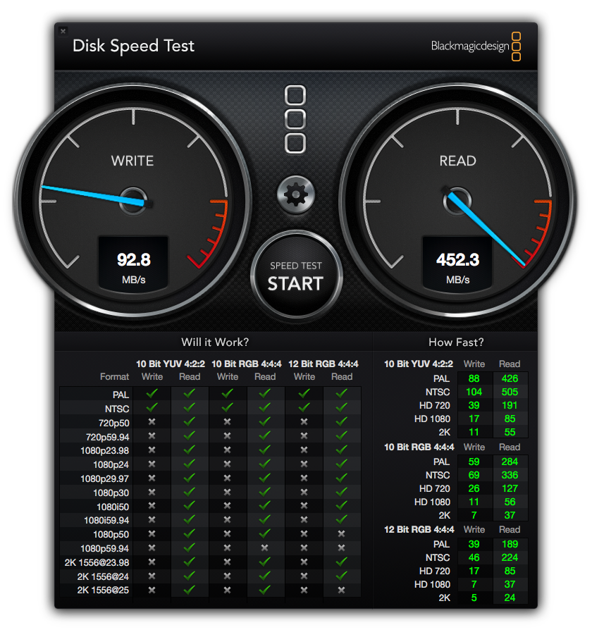

Out of curiosity I did a BlackMagic DiskSpeed on my MacBook Pro (late 2013) and here is the result:
It's nearly 100 MB/s more than on my Mac Pro (late 2013) !
(the write speed is probably due to the lack of TRIM, I don't consider it)
What could explain such a difference, taken UASP is active (yet I'm not sure how to be sure it is)?
As a side note, on the aforementioned Mac Pro, I sometimes have 40 MB/s max throughput on any external drive I plug in. I have to unplug/replug to reclaim my 360 MB/s on the external SSD drive.
Any help understanding this would be greatly appreciated!
