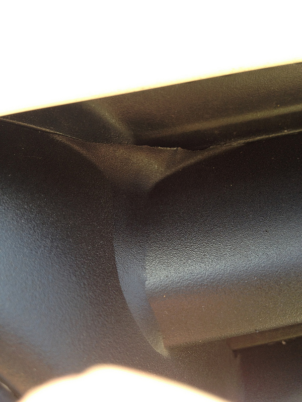

So I thought why not try clear plastidipping the back and applying the vinyl to it. Unfortunately that didn't work, as I applied the vinyl stickers it pulled the plastidip off the back.
I also ran into the issue of peeling with my cars grill I plastidipped a while back. I had waxed it before I applied the plastidip, and it prevented the plastidip from adhering to the grill.

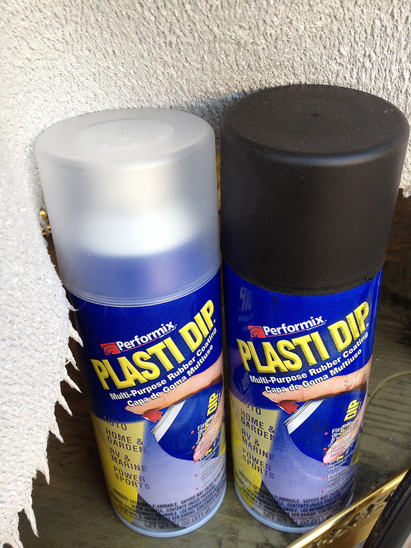

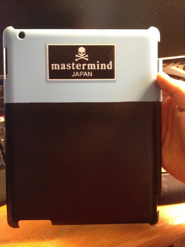

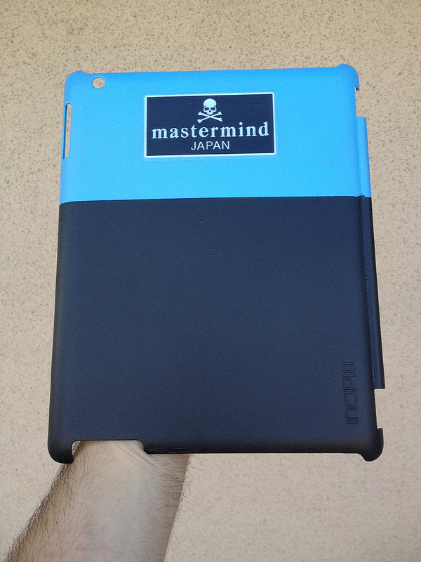

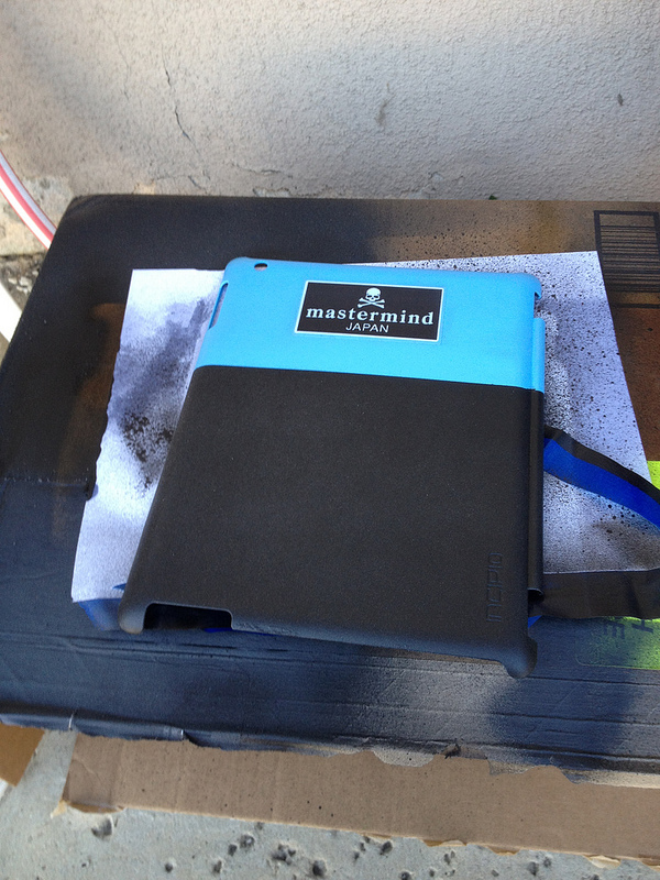

So I was back to square one. I got another sticker in from Japan, luckily it held a lot better than the vinyl, but I still wanted to protect the back and cover up the smudge. So i tried it plastidipping it again. I used the matte black which you can pick up at your local hardware store.
It's kind of messed up on the bottom and top left hand corners. I was running low paint in the can, so I had to tilt it. Unfortunately it came out a lot more thicker and I had overspray in those areas. I'm out of paint at the moment, so I will have to wait until I get more to redo the areas.
Finally I took a can of the clear plastidip to coat the entire case. I did this to seal the entire thing off. I didn't want the plastidip to peel or tear off later. We will see if it holds, I just did this an hour ago, so the durability on a incipio feather case is unknown. Message me if you have any questions.
Tips: Buy good masking tape like 3m quality. I purchased a cheaper brand at Walmart and it peeled off as I was painting which messed up my lines. If you want a straight line make sure you peel off the masking tape after about a minute so it doesnt adhere to the masking tape. If you wait you will rip off the rest of the plastidip.

love plastidip too - but won't the flexing of the cover enhance it peeling off?
Plastidip will flex. The only issue is with the corners. If your constantly taking your cover on and off you will run into an issue. But you could always get around that by masking the corners entirely.
