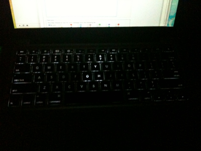

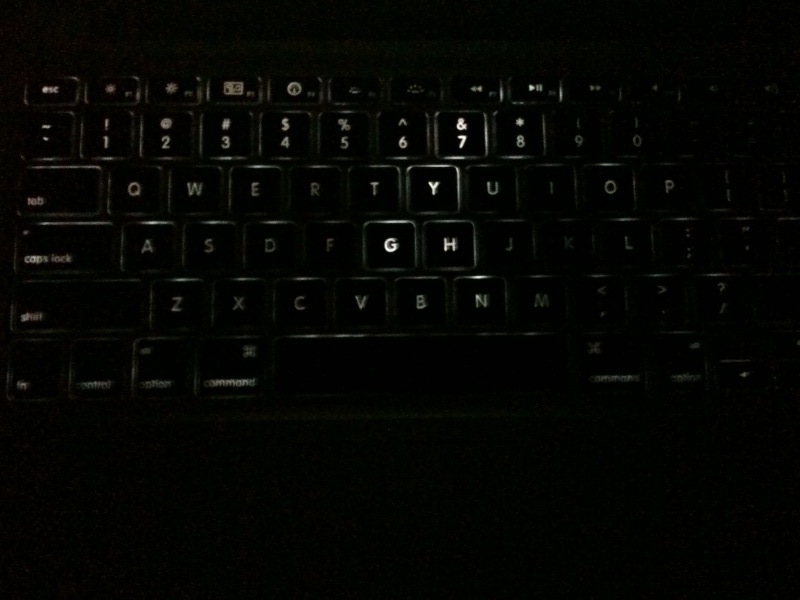

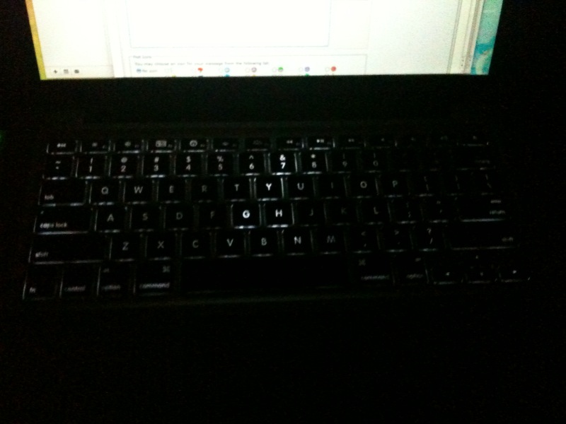

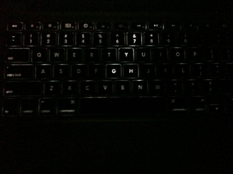

So I spilled orange juice on my 2.26ghz mid 2009 Macbook pro keyboard. 🙁 I turned it off right away unplugged it and turned it upside down. I took the back off and cleaned and dried it all out. after letting it dry for a while I turned it on and everything seems to be working normally apart from a few sticky keys which I'm slowly taking off and cleaning and the facet that the keyboard lighting is no longer consistent. So my question is How does the keyboard lighting work exactly and how might I go about fixing it? here are some photos so you can see what exactly is going on.

all I really want to know is how the keyboard lighting works. How many LEDs are there? how to they illuminate the keys? What would cause some of them to go dimmer?
The LEDs shine through the translucent parts of the keys, which are shaped in the form of letters.
The only sure-fire way to get this "fixed" is to buy a new top case. There'd be some major disassembly involved in cleaning the LEDs individually, and you'd probably break a few in the process.

It looks like the light is still shining through, I think the lights are working normally. More likely you have dried orange juice blocking the light under the keys.
I don't know how you can remove the keys or if you will just need to replace the entire top casing. Any liquid damage obviously voids the warranty. Do you have homeowners or renters insurance?

Wait. You took the keyboard keys off?
Yes, with a knife you can pop them right off. they're fragile though so you have to be careful.

Actually I know that this is a result of the orange juice. What I'm asking is more specifically why some keys are not as bright. (besides the broad reason of them having OJ spilt on them.)

Do you know if there is one LED for each key or does it have some sort of fiberoptic thing?
I have removed the keys and there is no OJ in the keys themselves but there may be some deeper in?
