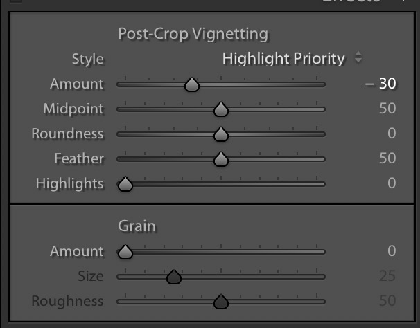

The crushing blacks is literally just pulling down the Blacks slider. You can add a vignette through the Effects panel, but I prefer to add a radial filter so I can control where it goes. I think the ones in these images used the Effects panel though.

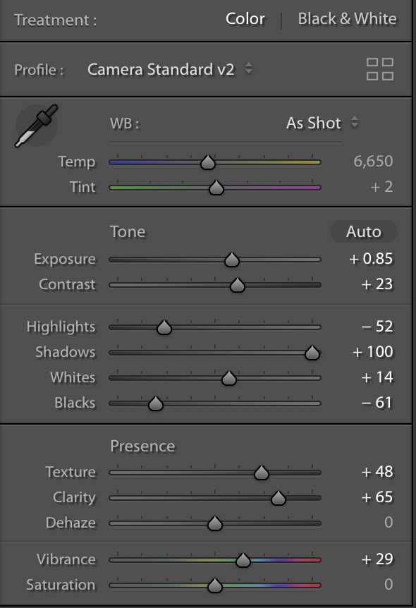

I think this would be similar - full sun image casting harsh shadows. I think the gypsy images probably have even more contrast added as you can still see blades of grass in my image; I think if the gypsy photog processed this there would be less detail there. But you can see some of my settings, which might help you get started. Changing the Camera Profile will change things quite a bit, as well as playing in the Calibration tab at the bottom; I didn't change anything in Calibration, but I wouldn't be surprised if that is part of GP's preset/workflow (I do often change this in my normal images).

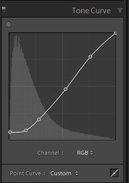

@mollyc has you in safe hands above.... another way to crush the blacks is to use the tone curve and make it look like a little like hockey stick e.g.
But you ill need to play with it a little as the amount of points and slopes etc is a fine tuning activity specific to each image.
