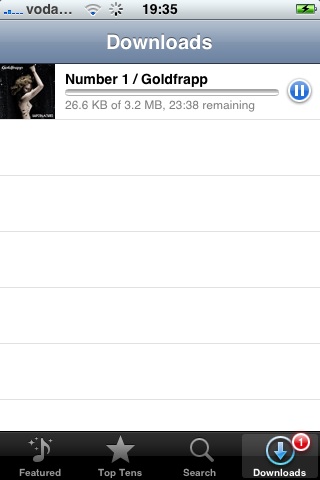

nope well after alot of rebooting the iphone i got it to work:
so far - unlocked to vodafone, activated and wifi music store is there but alas dog slow
excellent
