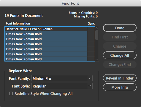

This is a feature in QuarkXPress. You can select multiple fonts in the usage list and then select one font to change ALL those selected fonts to the one you choose.
Since 2013 when I fully moved over to InDesign I have been unable to do this using Find Font.
I CAN select multiple instances of a font and specifiy the new font, but InDesign will only change the FIRST instance of a font.
Here is an example below…all these instances of Times Bold need to be changed to Helvetica Bold. But I can only do it one at a time.
That's a real PITA when I have many instances.
I have specific reasons to not be using style sheets in this particular instance and I know I could probably just find/change the font, but that seems to be even more work.
Does anyone have a solution or is this one of those instances where QXP is better than InDesign?
Looks strange to me, that there are 6 or more instances of the same font. I've never seen this in ID CS6. Replacing several different fonts with one other font is no problem. Could it be that there is some font cache problem or too many Times New Roman Bold styles with the same font name installed? Maybe you could upload a sample file (CS6 or idml)...

Well, typically this happens with Word files that I get for our legals. I believe it's multiple character styles rather than paragraph styles. And I'm using a very simple document to import it (a template). The idea is to make the changes I need to make within this template (which does not get saved), copy the text and then place it in our legal document formatted.
This avoids bringing over multiple Word styles and colors that I don't want cluttering my legal document.

In your screen shot it shows 6 instances of the Times New Roman Bold font. Is that a fairly typical length? If so, can you select one instance at a time and click the "Change All" button for each instance -- instead of clicking "Change/Find" for each instance?
Or did I misunderstand you and that's what you're already doing?
Wanted to mention I figured out what was going on.
The INDD document in question did not have one particular InDesign character style that I was referencing when importing the Word document. Consequently, it seems to have thrown out all these additional font references as a reponse.
Appending in that character style from our legal INDD document to this INDD document fixed this. Now when I import Word files there is no more font fragmentation.
