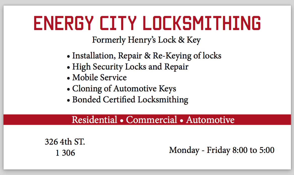

I was wondering if Indesign adequate for sign design? I already have a file in pdf format and was wondering if it could be made into a business sign?
The current design:

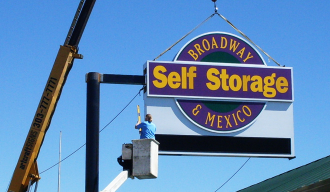

The sign would be similar to this:

PD: Both designs you posted aren't that good; one reads 'Broadway Self Storage & Mexico'. I bet those guys in the photo are removing it because how bad it is.

One more thing, before spending a lot of money for such a sign better pay a professional designer to design it. No offense, but your current "design" is pretty bad. The text flies around all over the place with no clear structure. There is too much information on that, no one is looking at a sign that long to read all of that, especially if it does not look particularly interesting. The text is too small, a sign should grab your attention and be readable from a large distance.

One more thing, before spending a lot of money for such a sign better pay a professional designer to design it. No offense, but your current "design" is pretty bad. ...
+1
  • Too much text. A sign of the nature of that in the photograph needs to be read in 3-4 seconds. If it takes any longer to read it fails
  • NEVER put business hours on an expensive sign unless you have a budget that allows for frequent replacements of the sign face. In the real world, business hours change periodically and changing the sign can/will be expensive.
  • A sign of that type is placed at the business location and thus doesn't need an address, other than perhaps a suite number.
I second all these points.
If you feel the need to put hours and an address, you could have the bottom half fabricated as a separate panel. That way, if you move or hours change, it can be swapped without having to replace the main face.
