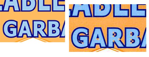

Im stumped with this one. (see examples below)
Doesnt matter what file, doesnt matter from what computer, if I print certain things from InDesign CS3, I get some strange errors.
It looks to me like something to do with overlapping strokes and fills.
Ive tried exporting as a .pdf, print still has same exact problems.
This only occurs with our Color Laserjet, the BW laserjet is fine.
Only way to work it is to export as a 300ppi .jpg and print that. But, cmon, what kind of workaround is that!?
(PDF on left, print scan on right)
notice the white dot?
and the blocks of missing color?
What is this!?

Printing from AI, same errors.
I never had this problem until just one day it started happening. No upgrades, no new nothing, just bam one day. If I.T. did something in the dept, they never told us and are being a little slack on helping us figure this problem out.
It doesnt seem to just happen with fonts, on another project I had a drop shadow on about 30 objects. Indd and PDF looked fine. But printing it caused blocks of some shadows to be missing.
