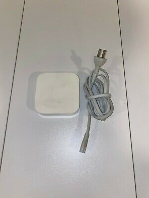

If you're only planning on airplay, an airpot express and amp is more than enough, and cheaper also

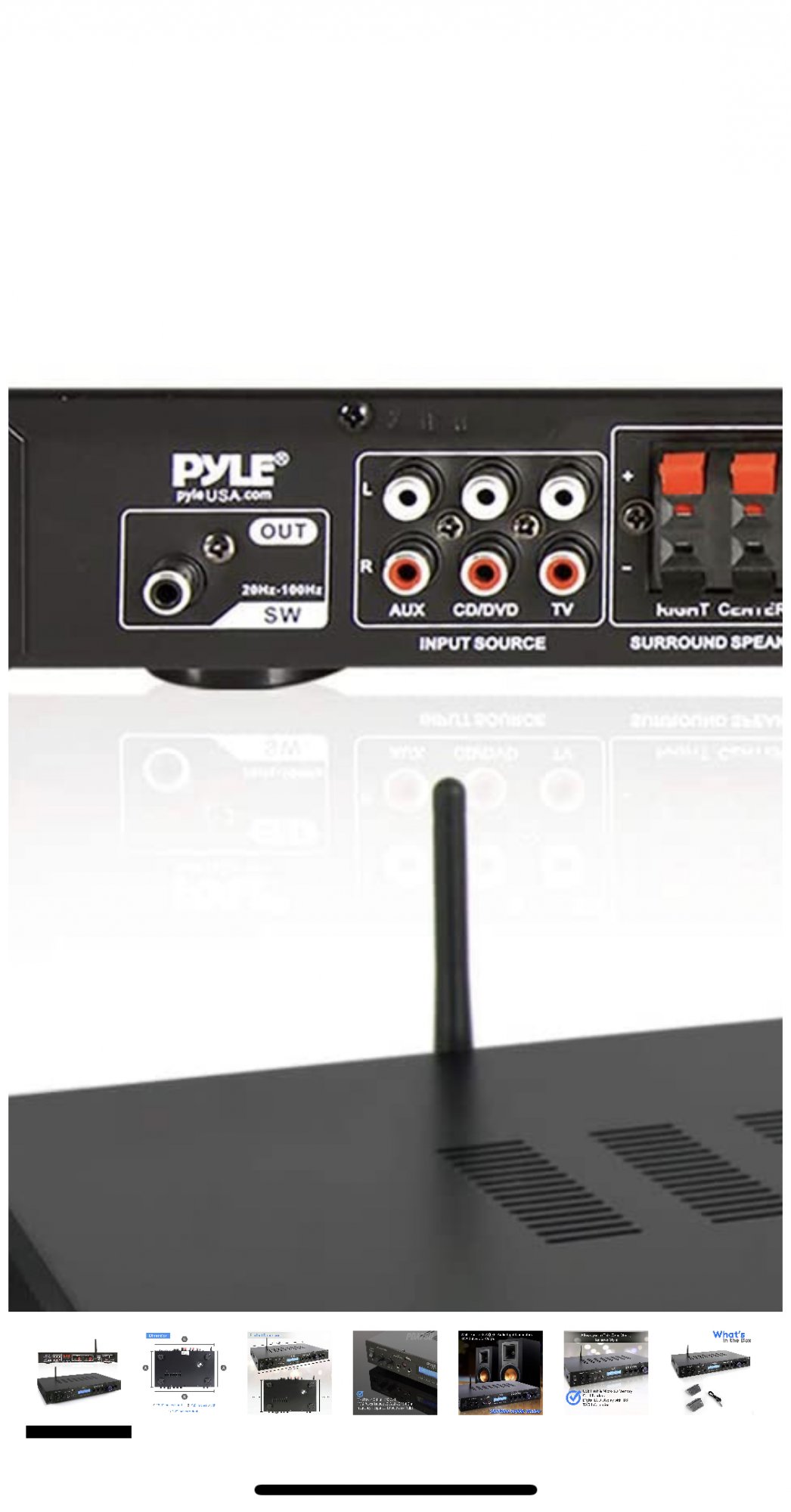

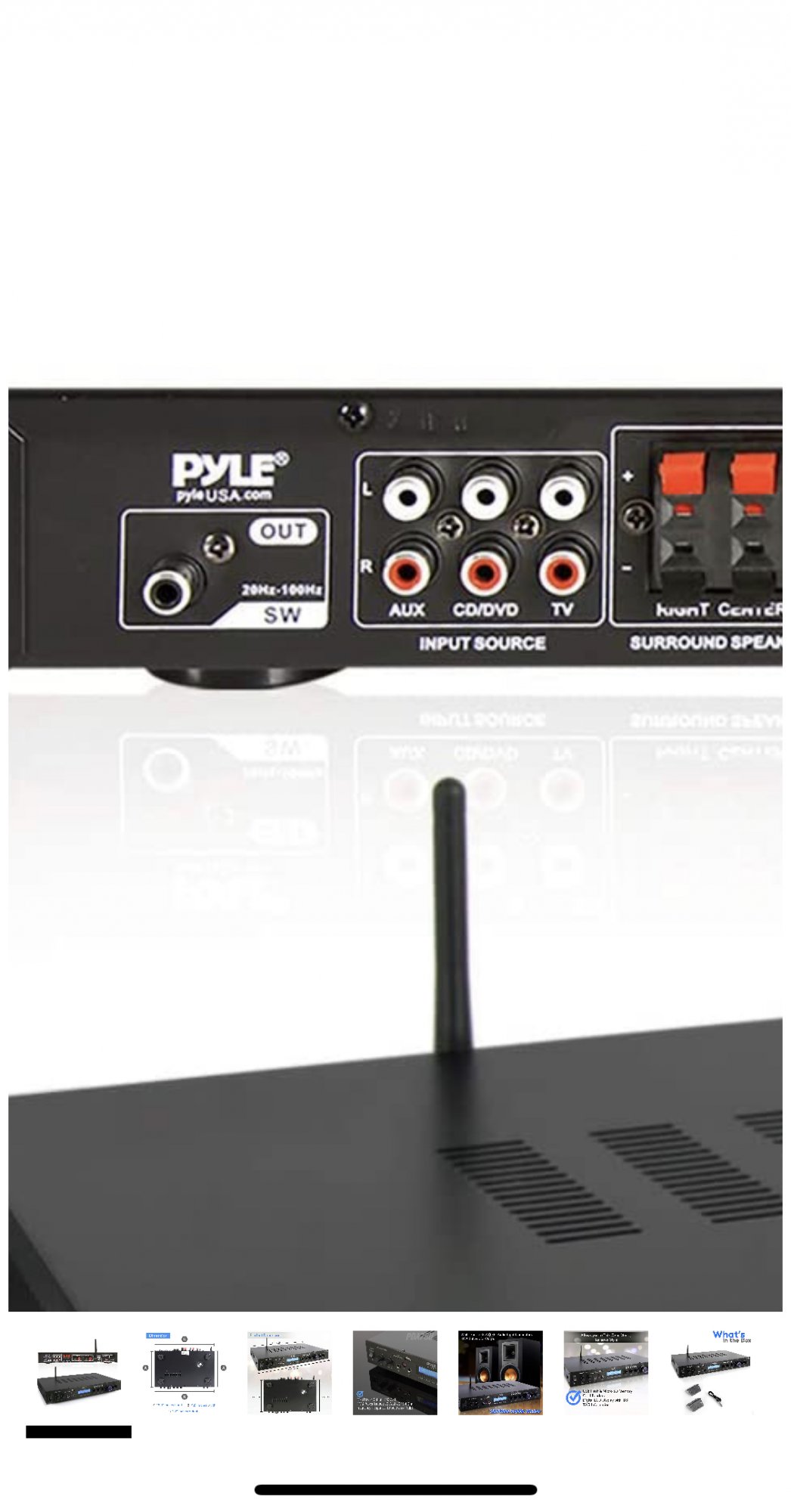

This is the device. I have four speakers so I guess I would need at least a four channel amp. This one has five and wouldn’t mind adding a fifth in the future.
Pyle - 5 Channel Rack Mount Bluetooth Receiver, Home Theater Amp, Speaker Amplifier, Bluetooth Wireless Streaming, MP3/USB/SD/AUX/FM Radio, 200 Watt, w/ Digital ID3 LCD Display from - PDA7BU,Black https://www.amazon.com/dp/B0777B3TYQ/ref=cm_sw_r_cp_api_i_PjigFbV2DTR54

Yeah, there are, but with added cost of adapters, you might as well get an AP Express.
If the AP Express with AirPlay 2 is out of your price range, maybe consider an older AP Express with AirPlay 1, as they are really cheap.
You have multiple ways of connecting an AP Express to a receiver or amp, as they have both an analogy and digital optical port using a Toslink cable.

Much appreciate all the info. I got burned on some used stuff in the past so I usually tend towards new and it’s difficult to find a new AirPort Express especially anywhere near the lower cost of an ATV4 (Don’t need the 4k for obvious reasons lol). The HDMI to RCA adapters and cables are cheap too. Not looking to go nuts. Just some casual poolside listening. I think I’m gonna try that Pyle Amp and an ATV4 with an adapter and see how that goes. I’m sure I won’t have volume control from my iPhone or AW. I envision it will work like an ATV4 that’s hooked up to an older TV where the TV Remote is necessary for volume control. Part of the reason I wanted built in AirPlay(2) support. Siri control too. Thanks again for the helpful info.

I guess if you are trying to find a new one an AP Express would be priced more as it would be pretty rare to get one unopened.
Even with getting burned in the past with used products, I would look into getting an used AP Express.
It make things much more simple and faster setup than an ATV, and they cost a fraction of the price of an ATV.
They are going for about $60 on eBay for the AirPlay 2 Model, and a $6 cable to connect the AirPort to your Pyle Amp:

Thanks for the recommendation. I did a test run with some really inexpensive equipment I purchased on Amazon and I’m pretty impressed with how well it all works. Got a Pyle Amp for $72 with 5 channels and made sure all the knobs and switches on it were the type that can be left in their previous state for power and input. Four outdoor rock 6.5” speakers for $170 total (turns out the speakers that came with the house were shot and irreparable but the in ground wires were salvageable. The speakers on Amazon admittedly look terrible for rock speakers but sound ok for my use case), a $20 HDMI input to RCA output module, hooked up to an ATV I’m not currently using and the amp plugged into a Wemo Mini smart plug. I created a Shortcut called “Going Swimming (turns on the Amp Wemo Mini, awakens the Pool houseATV, sets playback destination to the Pool house ATV, set volume to 50%, play a selected playlist and open the music app) which has worked flawlessly. I have an eero pro in the pool House so wifi in the area is good. I can control the volume and songs all from my wrist while in the pool with my AW. I also have a Shortcut that undoes everything (pause music, set playback destination to iPhone, sleep ATV, turn off the Amp Wemo Mini). This is all temporary but extremely pleased with the results for now. The season is almost over anyway.
