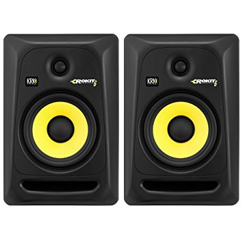

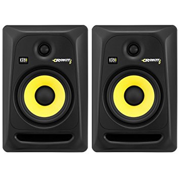

I'm an audio noob who is looking for an inexpensive DAC or a sound card to drive a pair of active studio monitors (KRK RP6 Rokit).

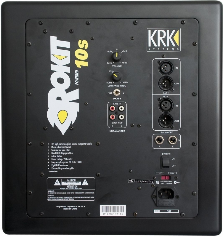

The device needs to have left and right XLR or TRS outputs. If that matters, the signal goes from my sound card to the monitors through a KRK subwoofer (looks like this from behind). A pair of XLR cables connect the monitors with the subwoofer and a pair of TRS cables connect the subwoofer with my current sound card.

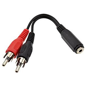

I suppose I need something like this:
...and a 3.5mm audio cable to connect to the 3.5mm jack of my Mac or an audio device. Are there any disadvantages of using such a setup compared to a pair of TRS cables?

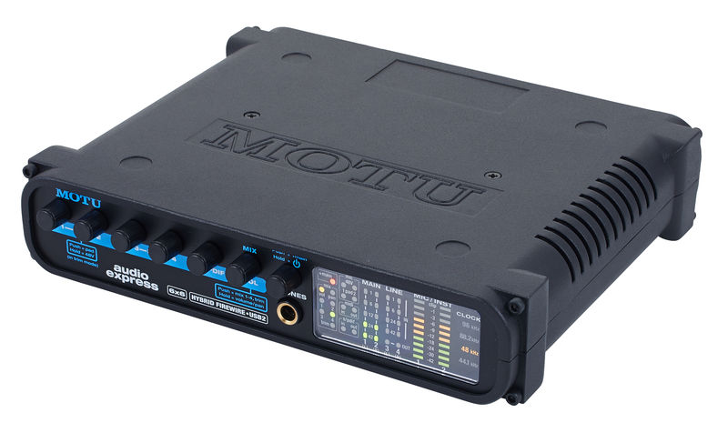

I was able to get a used MOTU Audio Express,

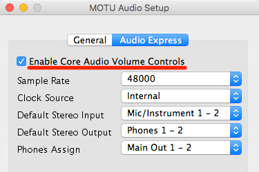

and guess what I found in its driver?
Now I don't really need menuBus, which still keeps crashing several times per day.
