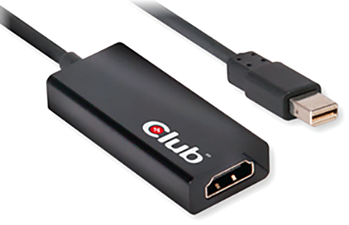

I thought so... So would HDMI out of the TV into an adapter into mini display port on the R9 280X work? Just checking... Thanks
Only if that adapter is explicitly labeled as "DP 1.2 to HDMI 2.0". I think Club3D has introduced one last year.
Reactions: Zwhaler
Now I'm only wondering if this would give my TV 60hz on Mac Pro 5,1 or if it only works on the late 2013 model.
It should work fine, the R9 280X is perfectly capable of outputting 4K@60hz through DisplayPort. I never used such an adapter myself though, but I've seen positive reports.

Btw I did not have success with this product. Just letting you know. Not sure exactly why but it doesn't look like there is an easy solution, if any, for the Mac Pro 5,1. I'm using it with a brand new 2016/2017 55" 4K Samsung KS9500 series TV.
http://club-3d.com/index.php/produc...layport-12-to-hdmi-20-uhd-active-adapter.html
Didn't work at all? Or did it max out at 4K@30Hz? Were you using an HDMI 2.0 cable?
Might be possible to force higher resolutions with SwitchResX and/or the Pixel Clock Patch.
If you've Windows on your MacPro, it would be interesting to verify if it's physically working.

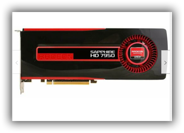

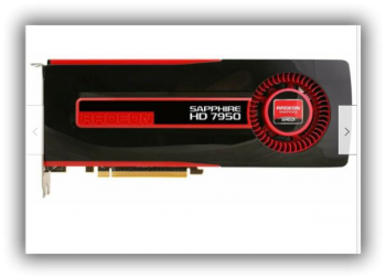

flashed MSI R9 280x will never boot with 4k monitor connected?
Is there a metal capable GPU that
- boots with 4k60hz without a problem
- has boot screens
Maybe AMD Sapphire Radeon HD7950 3GB GDDR5?
Thank you.
