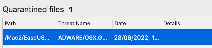

I have the same problem with a file in the Mac2 which I am denied access to. It keeps being quarantined by every anti-virus I have tried. I delete it and it just keeps reappearing. I have read all the answers here, and tried the solutions mentioned, but every time I just get the word "password" and a locked key, which will not let me type in my computers password or anything else. Anyone got any other suggestions please? THis is the annoying file/programme that keeps getting quarantined.
