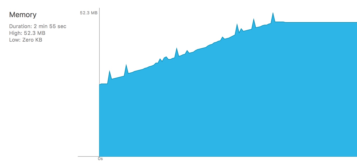

Hello everyone, I have been stumped by a programming issue, and would really appreciate any input from a veteran.
Specifically, I believe I have a memory retention issue. My application should be able to run for days on end, but there is a memory build up that eventually causes the application to crash, potentially costing me the results. My program structure is the following:
View Controller, which acts as the main GUI controller and handles all interactions on the GUI from the user. It also possesses objects that control the flow of my program. Those objects have child objects that handle individual iterations of my program's business logic. For the sake of clarity:
ViewController shall be object A.
SubController shall be object B, child of A.
Worker shall be object C, child of B.
Each of these levels has interactions with a single item on the GUI, a console that updates the status of the process and reports any items of note found during the business logic's runtime. Objects C and B both update the console via asynchronous dispatch calls to the main thread. I'm not sure if this is relevant to the problem or not, but I wanted to be clear that all objects have a reference to this GUI item, the reference for which is passed as a parameter to the children.
My application's memory pressure looks like that. The spikey and gradually rising part is during the process where the workers are doing their task, and the flat part is after the iteration set is complete and the workers (and their sub controllers) are released. This is only after a few seconds of running, and over the span of days will eventually fill the system's memory. In my mind, the application should return back to it's original memory pressure when the Worker C is released after it's iteration is complete. However, obviously memory is being left over. When I transfer my session to Instruments, no memory leaks are detected. My application uses ARC to manage memory.
It should probably also be noted that my SubControllers B spawn multiple threads to run multiple Worker objects C at the same time. I'm not sure if multithreading might be interfering with ARC, but it was worth noting. I'll keep an eye on this thread to answer any follow up questions to the best of my ability.
1. What do you mean by "child" in "child of A" or "child of B"? Does it mean "creates the object" or "holds a reference to the object", or both? If it's holding a reference to the object (i.e. the object has an instance variable that holds an object reference (directly or indirectly)), then that reference will prevent ARC from reclaiming the object when the task is complete. This is significant because you mention threads. In general, if some object X creates an object Y that will be handed off to a thread T, then X should not hold any references to either the Y object or the T thread. As a design, I prefer to give a thread the responsibility for creating all objects it needs, rather than having some object X create objects that are then handed off to threads.
2. Exactly what causes "... Worker C is released after it's iteration is complete." If you're using ARC, you generally shouldn't be doing overt releases. If the "iteration" is a thread, then when the thread terminates all its objects should be automatically released. If the thread isn't terminating, then it probably should be (you should be able to inspect how many threads the process has, and whether that rises and falls in the way you expect). If your strategy is to keep threads around to perform more work (e.g. they queue up to await new work objects), then you probably need to coordinate that reuse with any object creation.
3. How did you generate the graph?
4. Written in Objective-C, right? OS version? Xcode version?

I should also mention that I have a custom object that simply holds the GUI options that is passed as a parameter. Consider that object D.

3) The graph is from Xcode, when you click on the sandwich looking icon on the left bar during runtime you can see the resource usage from your application.

Also consider running this through Instruments to see what is actually taking up the memory. It's hard to tell, but I wonder if your memory issues here are actually somewhere else. Especially if the workers are creating a bunch of text storage objects meant for use in the UI.
When I have profiled in Instruments, the memory seems to be in all parts of my application. The Workers create pipes and file data, and I can clearly see those pipes in the memory even after it is done with all iterations. The only time the workers update the UI is if something interesting happens, like an external process crash or hang.
As a further update, after a set of iterations there are no left over threads. Just a big container of memory that doesn't seem to want to go down.
I created a base method stub that essentially just does the Console updating, and doesn't create any worker objects (in place of LaunchWorker). And to my surprise, the memory has the same build up issue. Clearly the memory that isn't being released is happening prior to the workers doing their bit.
Playing with this, I decided to run 1000 iterations with the base stub. The program starts at 27 MB of Memory used, and after 1000 iterations it ends up at around 28 MB. If I run the same number of iterations again, the memory does not grow to 29 MB, but remains at 28. If I run 100,000 iterations after, the memory consumption reaches 36.3 MB. Running 1000 iterations after the 100,000 increases the memory consumption to 37 MB. What the heck?
The only thing I can think of that isn't being released is the GUI itself? Perhaps the formatted strings in the text view are keeping objects alive?

That's actually my thinking, and why I suggested Instruments. Obj-C types are all visible. Swift classes are also all visible (as Module.MyClass). Structs are messy because they are value types, so you will see stuff like _ContiguousArrayStorage<MyStruct> in the Allocation Summary of the Allocations instrument. I quickly wrote a small Swift app to double check all this (it just fires timers frequently, allocating memory and putting it in an array), and it holds up with XCode 9 at least.
The bit about appending text storage to the "Console" object, and scrolling a line down made me think that it may play a role. Without something to limit how many "lines" exist, you have unbounded memory requirements. And if that code is generating views, you will chew through memory a lot faster keeping those views around and in a scroll view or similar, than you will just keeping things like the attributed string around.
Table views and Collection views place upper bounds on how many cells they create for this reason. The backing data is usually small in comparison to the CGSurface backing a view/layer.

I think this could definitely be what I'm looking for. I'll think about what I can do, and post back here after I've tried a few ways of dumping the console contents.
