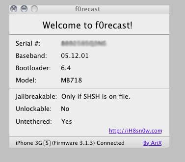

1. How do you know if you have the new bootrom or the old bootrom- which is old, which is new. These numbers mean nothing w/o some reference.
I used f0recast and got this screen.
attachment.php
2. Half the people are saying you need the SHSH on file, half say no need. Half say you need to downgrade to 3.1.2 to JB 4.0, others say no need
Ive been reading here, modmyi, and iphonehacks.com - I know better than to ask a question w/o searching 🙂 You guys are vicious!
Also, f0recast says it's not unlockable -can someone explain to me, kindly, why that is at this point - My assumption is that once its JB that the new ultrasnow could unlock any baseband.

thanks for the input guys. about another hour of google searching revealed I had the old bootrom, which is a good thing

In this case Spirit will not get you "stuck" on anything. In your case it seems Spirit is your key to JBing any OS 3.1.3+ using the link I posted a few posts up.
You should jailbreak and save your SHSH blobs to Cydia to ensure you have the freedom to restore to a earlier firmware should you have the need.
https://forums.macrumors.com/threads/953073/
After you do this, you can restore to a custom 4.0 IPSW using Pwnagetool 4.0.1 then unlock your phone with ultrasnow.
There's really no reason not to.

1. If you have version 3.1.2 or older SHSH backed up on Cydia you just need to downgrade and jb with pwnage tool or blackra1n, then you can restore to a custom firmware iOS4
2. If you have only 3.1.3 SHSH backed up, jb with spirit, and follow these instructions if you wish to upgrade to jailbroken iOS4:
3. If you don't have any SHSH backed up you can jb your current 3.1.3 with spirit, but you can't upgrade to a jailbroken iOS4...
If your iPhone is jailbroken (no matters if it's spirit, pwnage tool etc...) you can unlock with Ultrasn0w.
Hope that helps.

No you shouldn't have any issues using a new JB for iOS4 when it's released, if you use Spirit now.
I think you guys are confused. The OP can upgrade to 4.0 and jailbreak his phone right now following the instructions I linked to.
He does not need to wait because he has the old boot rom. I had this same problem and was able to finally jailbreak and mod the boot files to allow custom restores, thus allowing pwnagetool 4 to work.

You can't save 3.1.3 SHSH now, since apple stopped signing them.
If you're not sure if you SHSH are already saved, you can JB with spirit, launch Cydia, and check at the top "this device has SHSHs on file for iPhone OS..."
If your SHSH are not saved, then there is no way for you to jb/unlock iOS4 right now.
As I said, if you have new bootrom, you can't JB iOS4 now at all (no matter if you have 3.1.3 or 3.1.3 SHSH stored on Cydia). If you have old Bootrom, you should at least have 3.1.3 SHSH stored on cydia to JB/Unlock iOS4.

It also carries a higher risk since he doesn't have a 3.1.3 SHSH on file. You are modding files on the iPhone - so if something goes wrong during that process, guess what? Stuck with a stock iOS4. No one is confused or said it wouldn't work.
He's on 3.1.3 - he jailbreaks with Spirit than backs up his SHSH with Cydia before he mods the files.
No need for apple to sign the file. No risk.

He's on 3.1.3 with a 3GS, it needs a validation. Since Apple is no longer signing them, he cannot back up that particular firmware to Saurik's servers. If something goes wrong he will only have iOS4 (Stock) available to him until a new JB is released.

All you have to do to check, is open up cydia, at the top it will say "This device has SHSHs on file for iPhone OS:" and list what (If any) is backed up.
