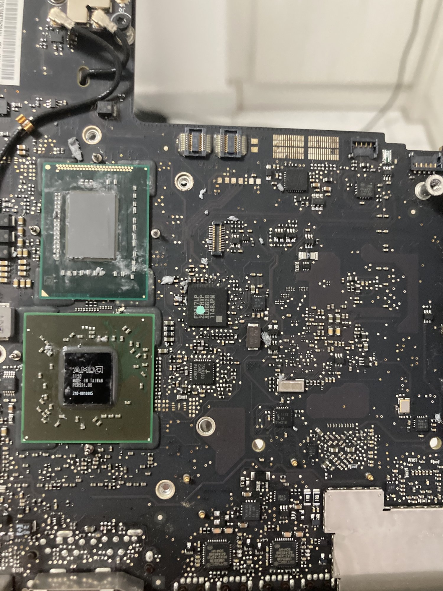

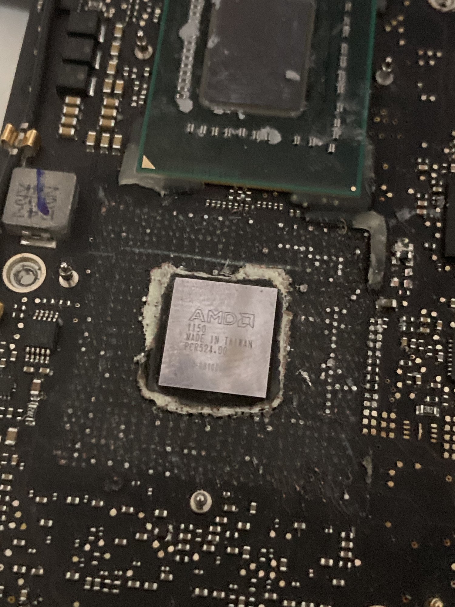

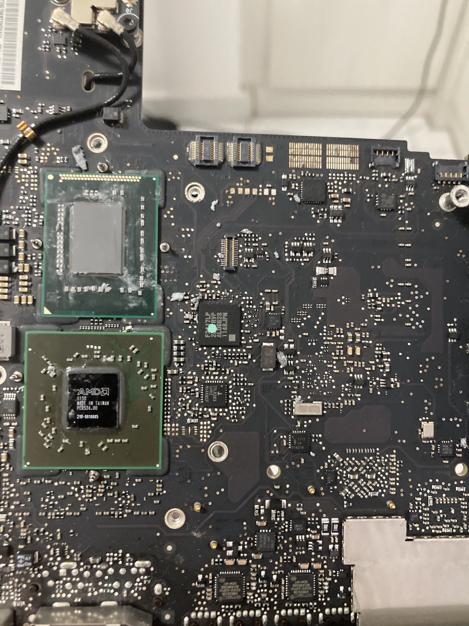

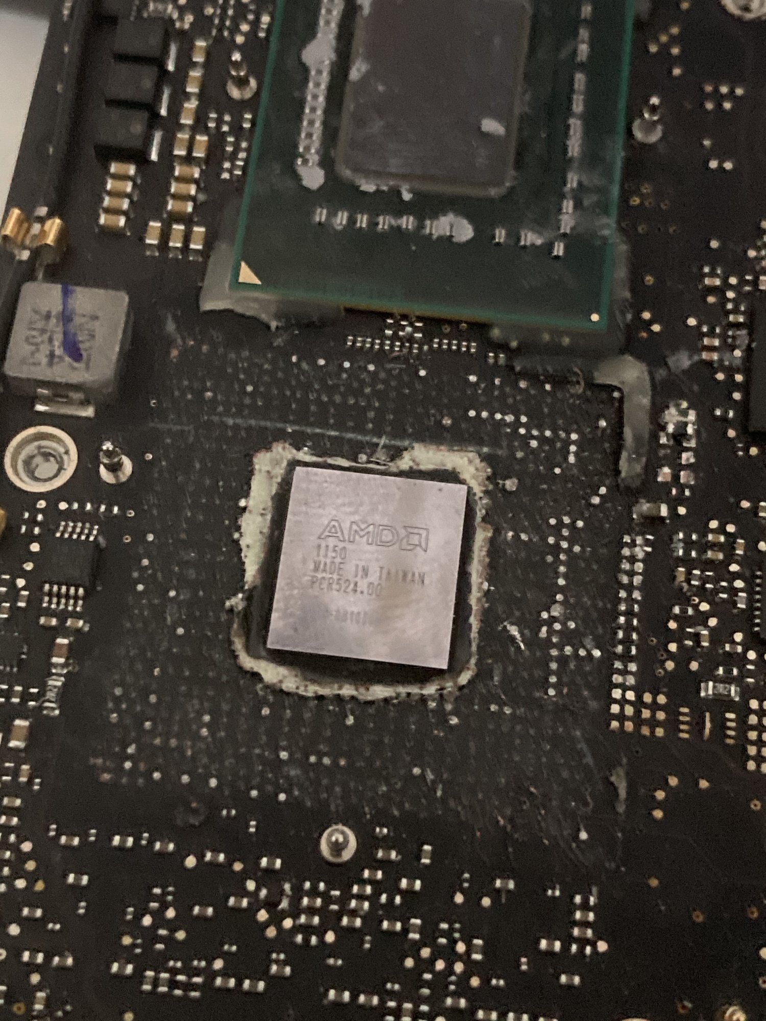

Mac mini 2011 has a mid model with Radeon that has made it easy to fail in the recent years too. So check if you have the Radeon model too. There is an additional ATI chip under the heatsink. I often wonder if ripping out that chip will make it go to the intel HD3000 😉, I can try it tonight, i do have a few 2011 with faulty Radeon..

Take a picture of the 2011 mac mini board an post it here? Mine was low end model, no ATI Radeon - just curious about Kaida's post above.
Here you go, i failed miserably trying to rip off the ATI chip off the mainboard lol

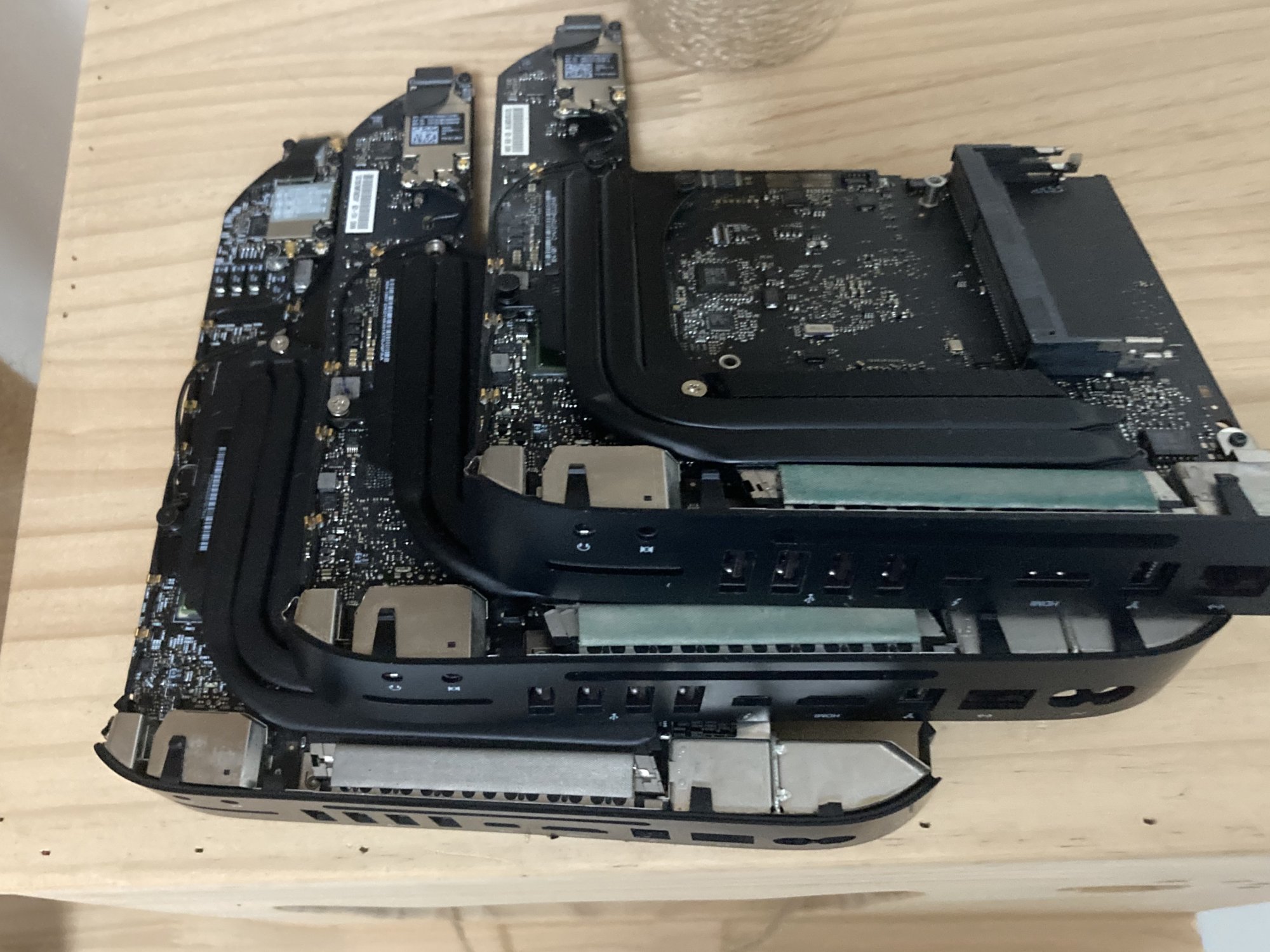

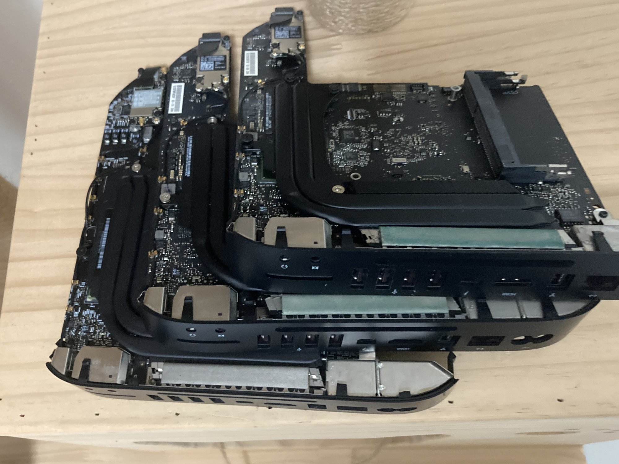

And here's a bunch of failed 2011
