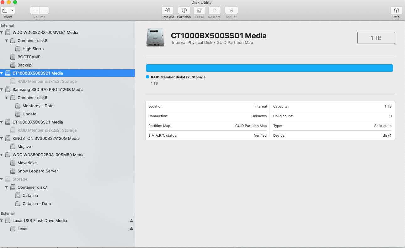

Thanks for this work @cdf. I've had problems with my internal PCIe SSDs on a Mac Pro 7,1 being ejected overnight for no reason and this looks like it has fixed that issue.
Reactions: startergo
That was short lived. I'm sure that Innie does reduce the number of times my internal PCIe SSDs magically self eject. This time it took 14 days previously happened nearly every night. The problem is the the only way of getting it back is to reboot.
