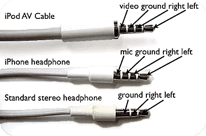

The iPhone uses a TRRS "standard" variant for 3.5mm jack which simply add an additional contact towards the bottom of the stem for the mono mic to run through. Apple then subsequently added that function onto all Macs since the iPhone, so that all the stock iDevice headset mics can be used on Macs as input as well, which is quite neat when there is only space for one jack.
On the MBP2016, for some reasons Apple decided to keep this ability, but took out completely the regular line level stereo input. This is one of the many puzzling decisions from Apple hardware wise, as this costs next to nothing to be implemented, does not waste space or battery, but its absence definitely hurts user experience. The only remote reason is to simplify the circuitry to minimize failure rates which only happens very rarely.

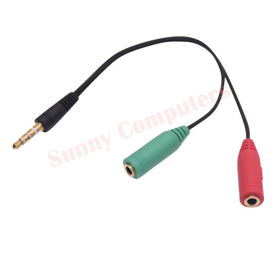

Hmm. So is there a possibility to create an adapter cable that contacts the mic level input like a pair of inline mic-equipped headphones do, but then has a standard 3.5mm female input on the other side? Or is the headphone mic implementation limited in some way that would prevent this?
Just thinking out loud here. I figure some sort of inexpensive USB/TB interface would easily do the trick, but if input can be tapped out of the 3.5mm still there's gotta be value in that for some users/cases.

They exist, Google "TRRS splitter cable" and you will get thousands of options.
Though the problems of such setup are obvious:
- it is only mono input on one end and stereo output on the other
- it is mic level
- the contacts are usually cheaply made, and even if it was not, there are still more places to get possible distortion / interference
- when split, analog signal strength is halved
So this is only a makeshift solution for chatting over mic, not one for music which a regular AUX line in can easily do. In the long run, a digital interface such as a dongle sized USB DAC / mic-pre is more ideal. The MBP dongle situation is a real struggle lol.
