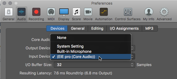

If you are using a USB device, then again, the audio preferences in Logic should be the first thing to check. What does it show as an input source? If everything is working properly, there should be an item in that menu that corresponds to your mixer. Here's a screenshot in Logic 10.3.2 on my MacBook Air. I have an EIE Pro USB interface (not currently attached, which is why it's shown in parenthesis). You should see something similar for your Xenyx if it is working properly.
