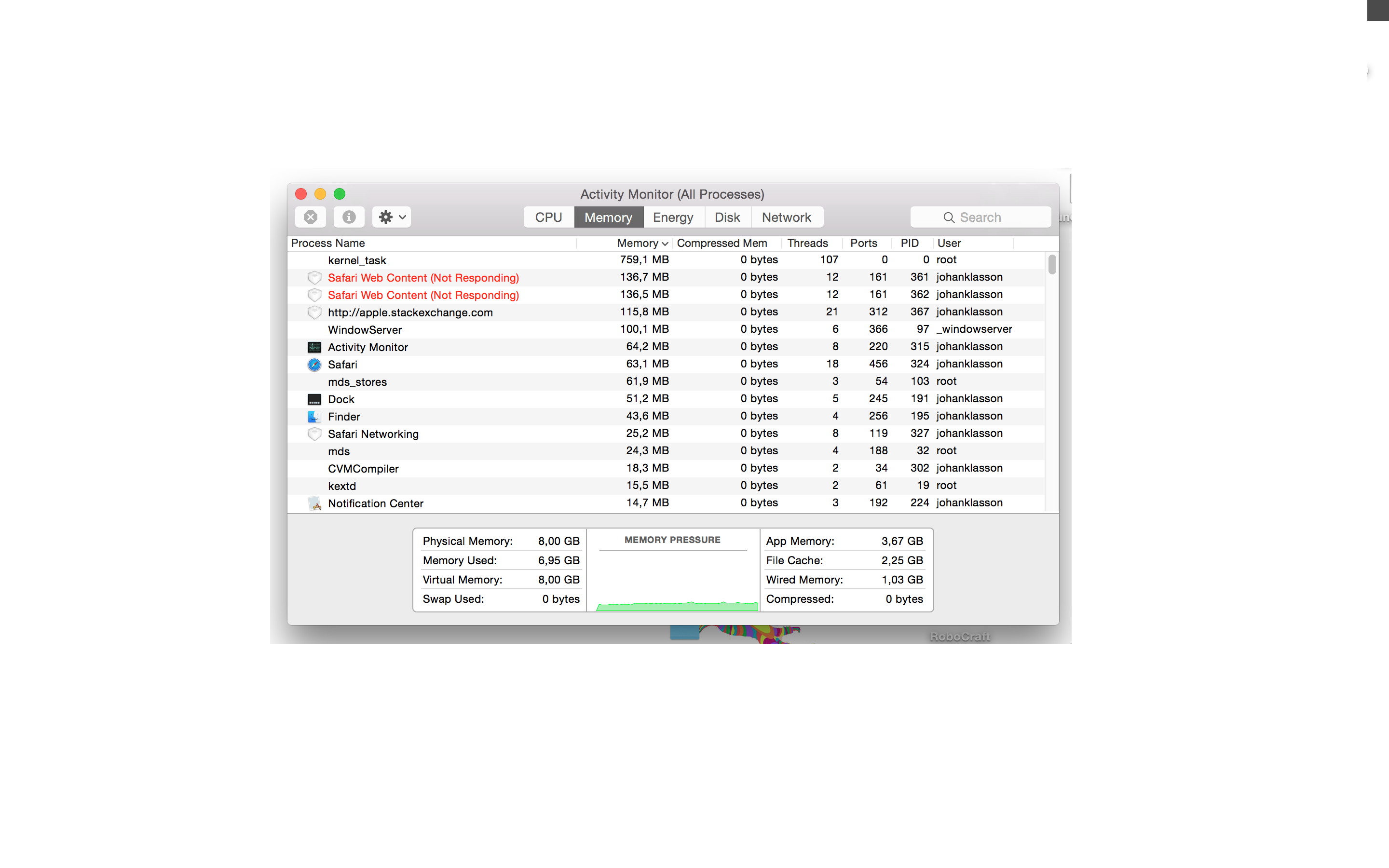

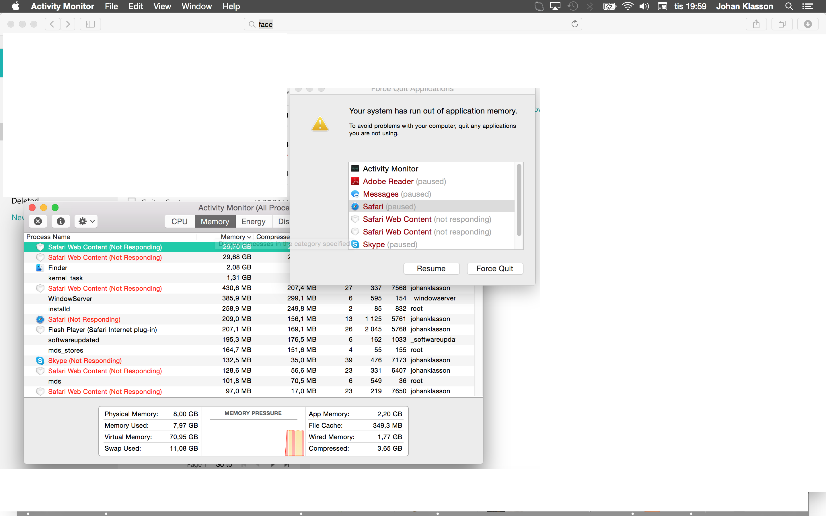

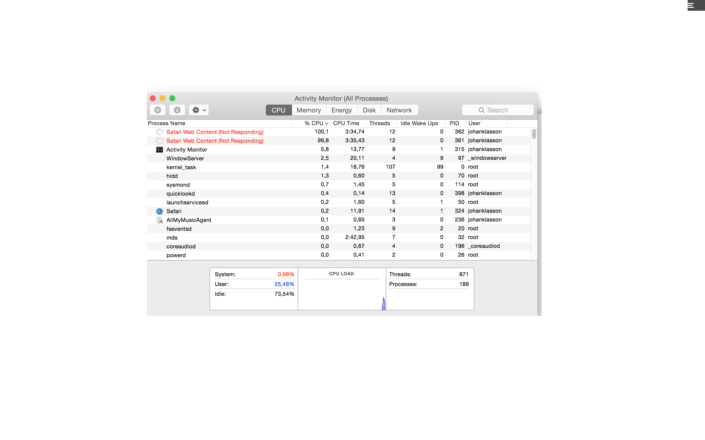

I suddenly got popup from OS X that multiple programs has stopped responding and uses up a ton of memory, all of it in fact. See the attached pictures. The only tabs i had open was a 5 minute clip on youtube, and my webmail. And the memory went nuts and crashed, and it does it still as we speak. And I couldn't do anything or open anything else. I have tried using the PRAM reset without any results. I haven't tried SMC reset, but will begin it now and check back.

Holy hell...11GB of swap used?!
Looks like it's a runaway process in Safari that's causing it to eat up tons of RAM. Could be Flash.
Have you updated your Flash?

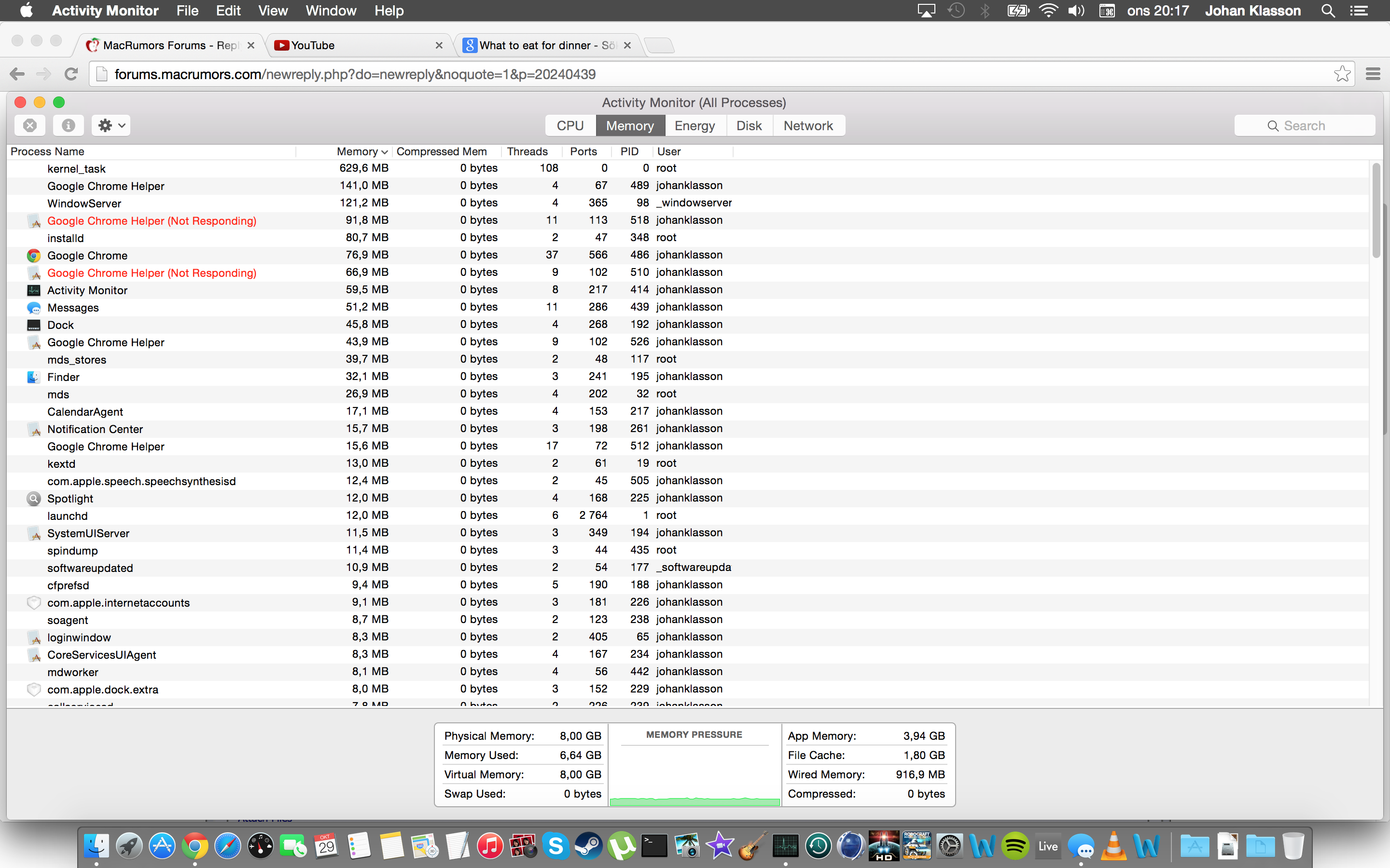

EDIT: I am not even sure if now there is anything wrong with this. But are youtube, macrumors and a google search page take up that much space. Oh in the picture it says memory used 6,64gb, now its 7,34gb. Is this normal?
