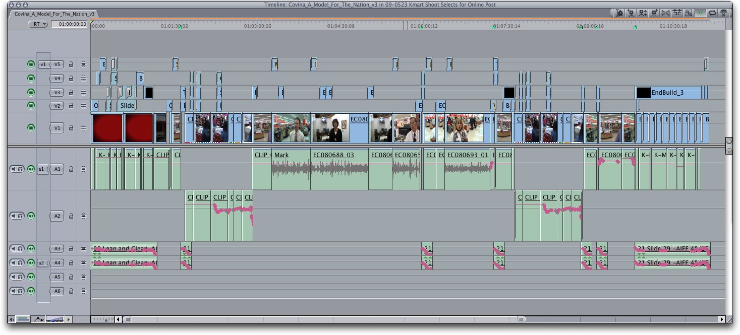

I wasn't referring to muting tracks in the timeline but to 'un-patching' the incoming audio from the source clip in the Viewer so that only the video is edited into the timeline. It's kinda hard to explain but this picture should help.
If you look to the left of the timeline you'll see three little 'nubs' labeled in lowercase as "v1", "a1" and "a2". These represent the incoming audio and video tracks from the clip in the Viewer. You can move the nubs around to place the incoming A/V signals on certain tracks and you can also 'un-patch' a nub to prevent certain incoming A/V tracks from being edited onto the timeline.
So, in the picture example, the incoming video is targeted to V5 and the incoming audio is targeted to A1 and A4, but the audio is un-patched so if someone performed an edit right now the video would go to V5 but no audio would be edited onto the timeline.
