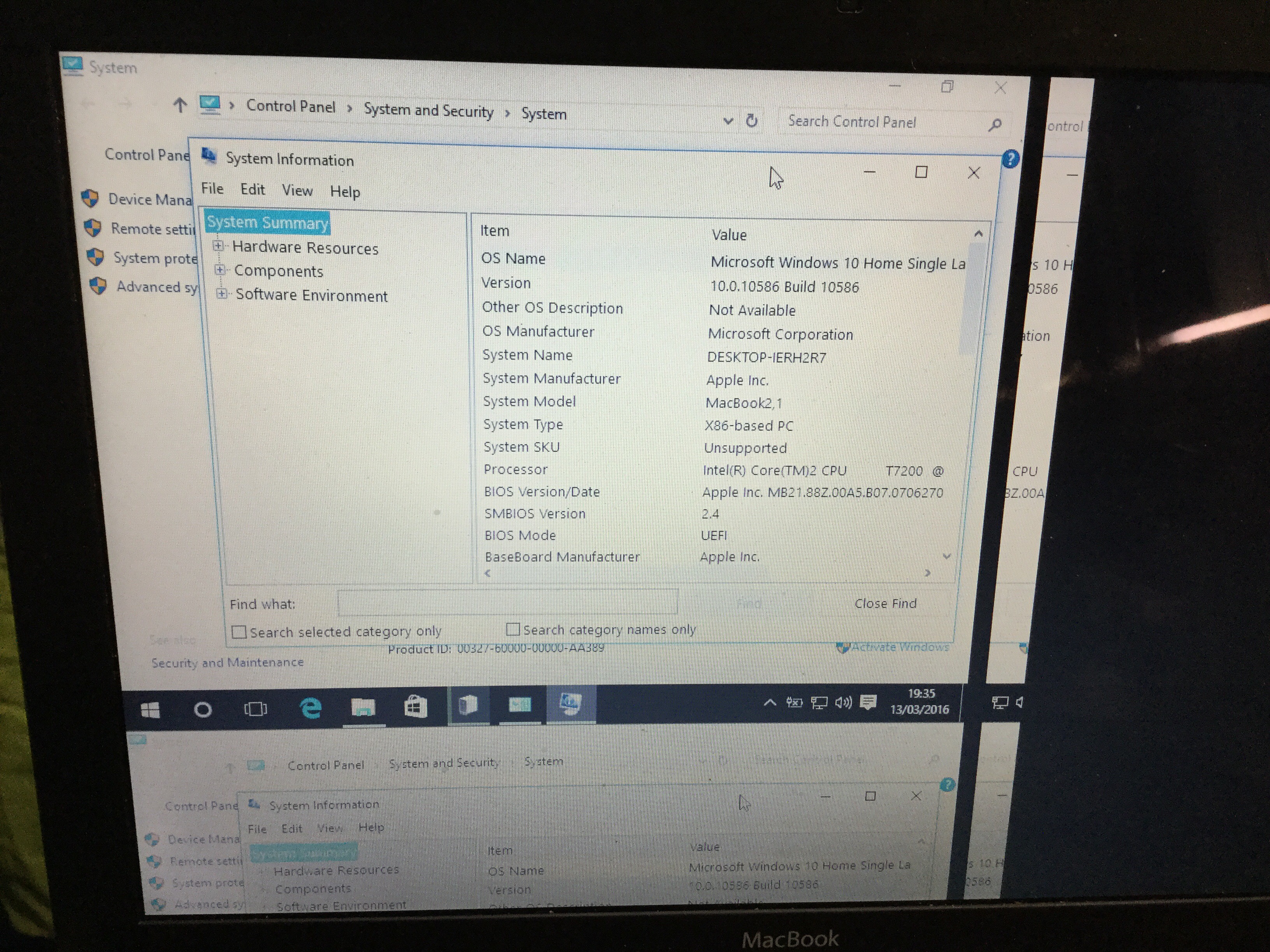

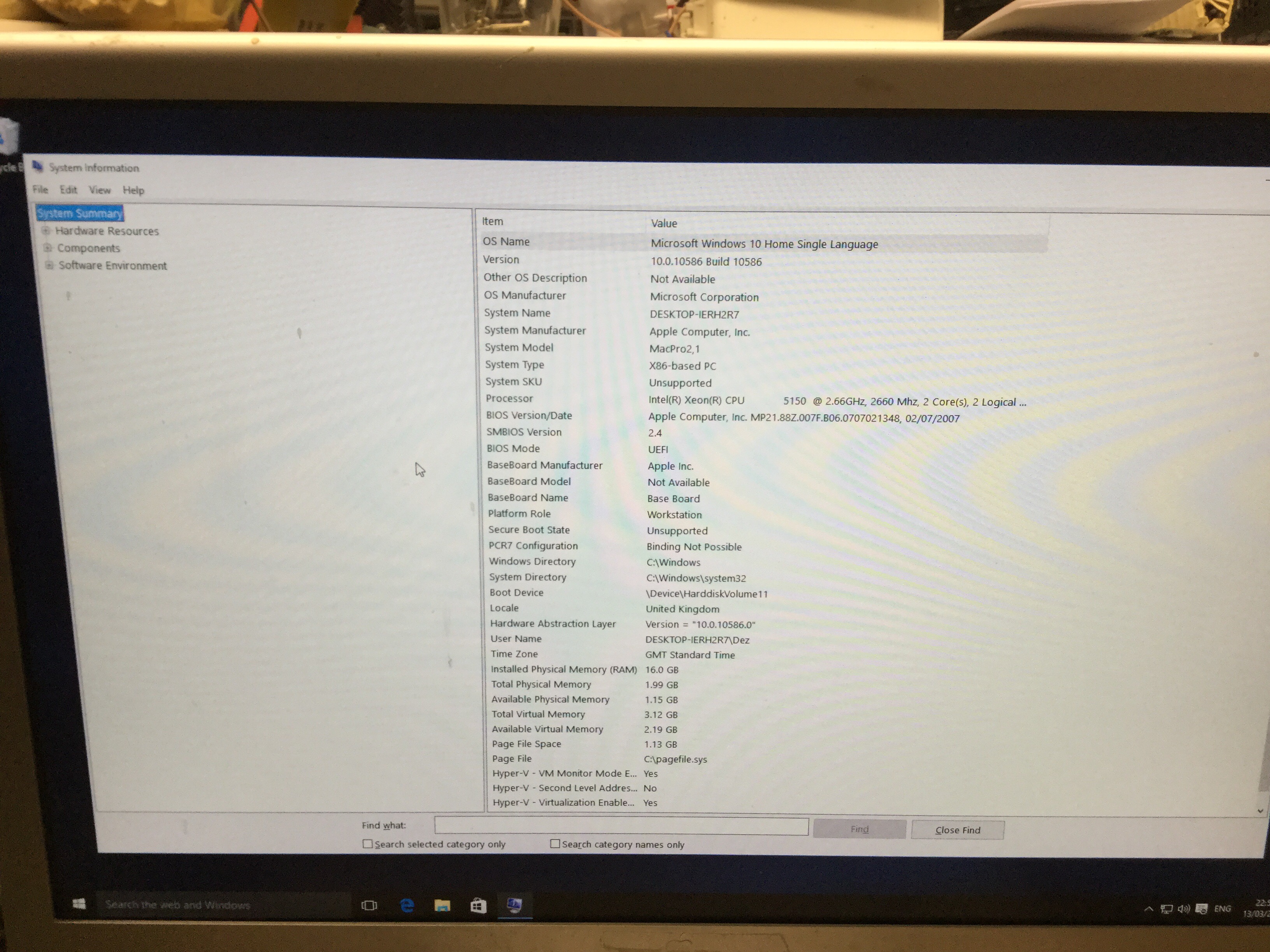

the thing is the Xserve does not include a BIOS compatibility layer in the EFI for windows so what i would try is setup a EFI windows install on a Mac Pro and insert it into the Xserve. due to how the EFI on most Macs (Mac Pro 5,1 and newer macs being the exception) handles the video modes on the graphics cards it only does UGA and not GOP/ the mode windows needs so you hit enter on the boot screen and it will seem to freeze when actually its Booting windows (Just windows has not taken over the frame buffer) If you remote in you should be able to control windows if it boots and install GPU drivers (or windows may pick them up automatically) i have had good luck with windows ATI 5770 drivers detecting the card and taking it over (aka it will suddenly switch from the EFI boot picker to a windows desktop) I was actually able to install windows in EFI Mode on A MacBook Pro 3,1 (with the MBP3,1 the nvidia drivers never played ball in EFI mode..) MacBook 2,1 (with the MB2,1 the GMA950 drivers didn't detect the built in LVDS LCD properly so got a bit glitchy) and even my Mac Pro 1,1 (Mac Pro was happy running like this) this way 🙂 (do note windows architecture has to match the EFI architecture in the case of the XS3,1 is 64bit) I hope this helps and makes sense (I have mentioned this before on the Mac Pro Forum heh)
