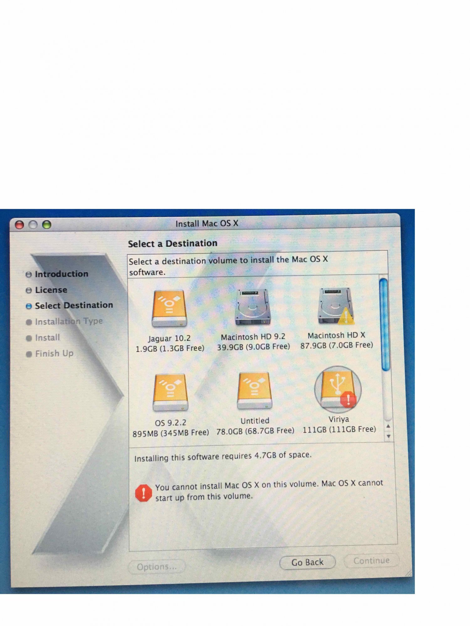

Is it necessary to partition the drive? This is a picture of what I get.
No, just one big partition is fine as long as it's in APM format.
But the problem is... Tiger will not install onto a drive attached via USB because PPC Macs cannot officially boot from USB. You have to install the drive internally, attach it externally via FireWire, or install Tiger on another drive it can boot from and then clone it over to the USB-attached drive.
If the PowerBook doesn't recognise the SSD when it's installed internally via an adapter, I'd check the adapter (which one is it?).

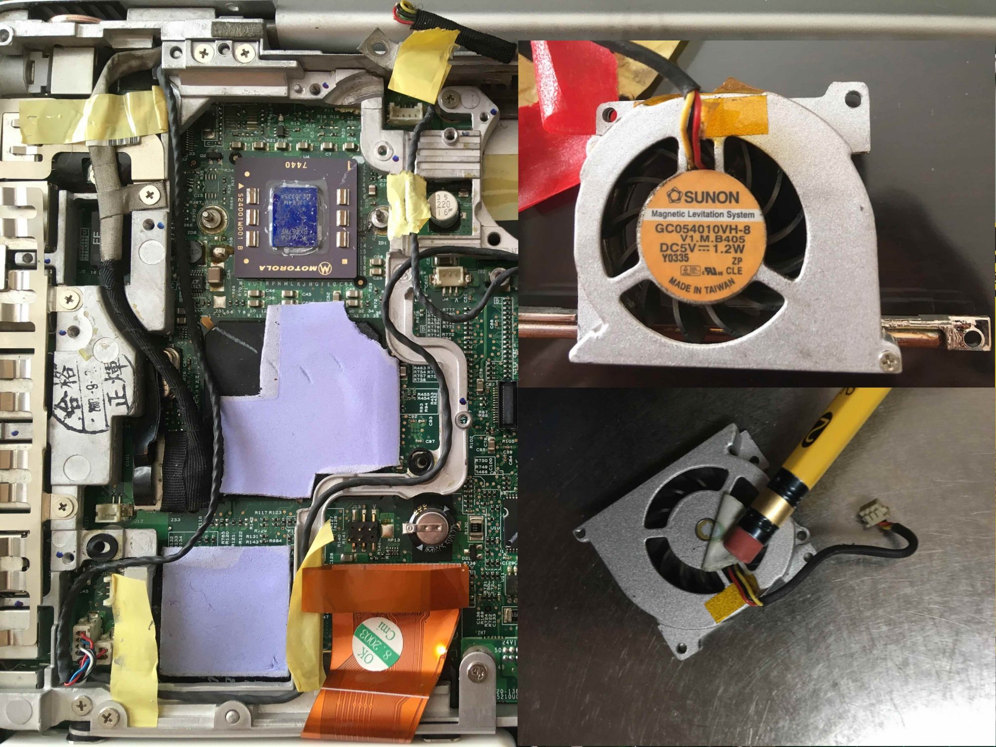

Hello! A couple of days ago I opened the computer again. After removing the fan I couldn't find where to lubricate it. Is it possible or it is sealed? There are some thermal pads bellow the processor. Should I changed them as well? Please see attached photo.

Now the fan seems to be the issue. It switches on every time I load an application.
Please look here:
I think you have a broken solder joint on one of the heatsink mounts. This causes the CPU to overheat very quickly.
Please look here:
Thank you for the link. It has interesting information. Do you see the broken solder joint on the picture I attached before? Also, is it possible to lubricate this type of fan?
