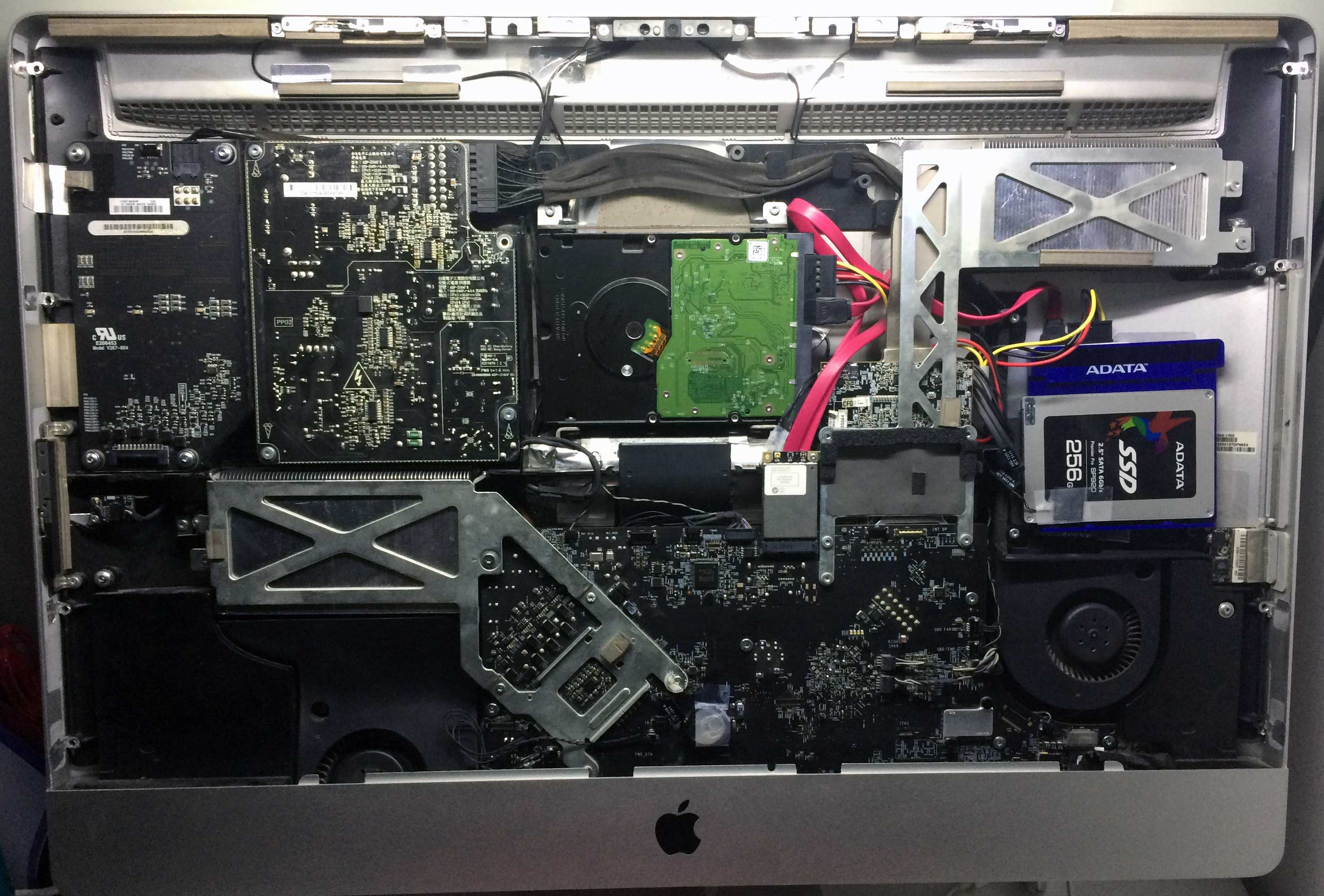

Before that, I am running MacOS on external TB SSD and internally a 256gb SSD (Bootcamp) & 3.5" WD 4T Re without any problem
Today, I got the 13pin SATA power splitter cable and install all 3 hard drives into the iMac.
MacOS SSD uses SATA 0
BootCamp SSD uses SATA 1 (share power to HDD)
4T HDD uses SATA 2 (get shared power from Bootcamp SSD)
That 4T HDD never detect in MacOS, the system shows no device connected to that SataII port
then I tried swap power cable & SATA cable with Bootcamp, same results - 4T is missing
Anyone got it works?

There are three power headers on the 27" Mid 2011 iMac (HDD PWR, SSD PWR, and ODD PWR). If you are going to share power, I would have the HDD on its own power header and then split the power coming from the SSD or ODD PWR header.

So what you mean is:
SATA1 data <> SSDMac
SATA1 PWR (shared) <> SSDMac PWR
SATA1 PWR(shared) <> SSDWin PWR
SATA2ODD data <> SSDWin
SATA0 data <> HDD
SATA0 PWR <> HDD PWR
correct?

it works!!
HDD @6G
SSDMac @6G
SSDWin @3G
everything works very nicely.
GPU temperature drops after cleaning all the fans
SSDs placed side by side vertically for best GPU heatsink cooling (i mean L & R)
sensor problems solved by MacFanControll perfectly
Now, I can move on to the next big thing - eGPU!
thanks @RyanXM

I would try to rearrange it so the HDD is on SATA1 (3G). The SSD's can take advantage of the 6G speed. The HDD can't, really.

oh. I am so stupid ...
I should mix the use of PWR and data cable ...
Let me change them later when I upgrade to wifi AC & BT4.2 card

Glad you got it working! SSDs use less power during use than a HDD, especially newer ones.
