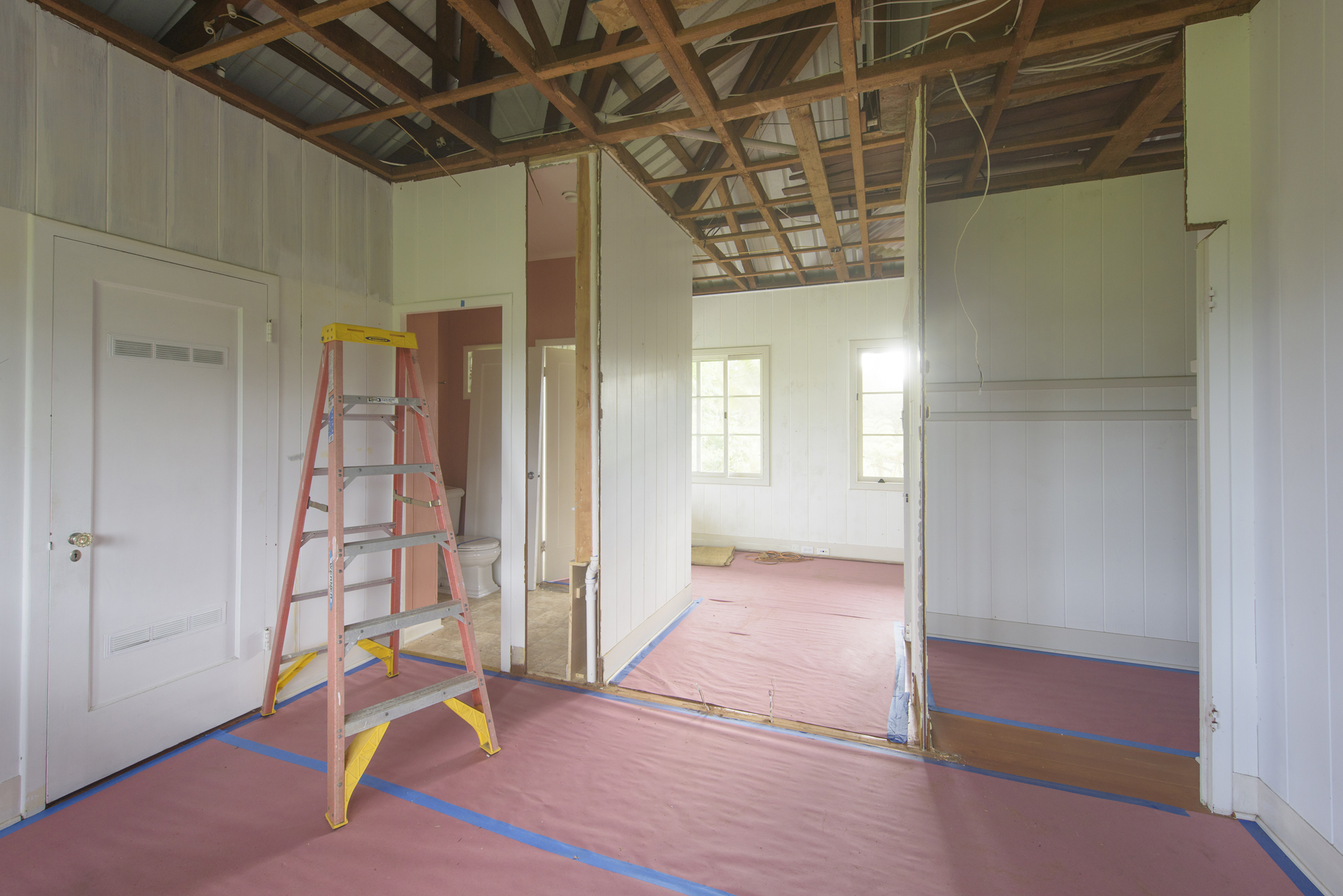

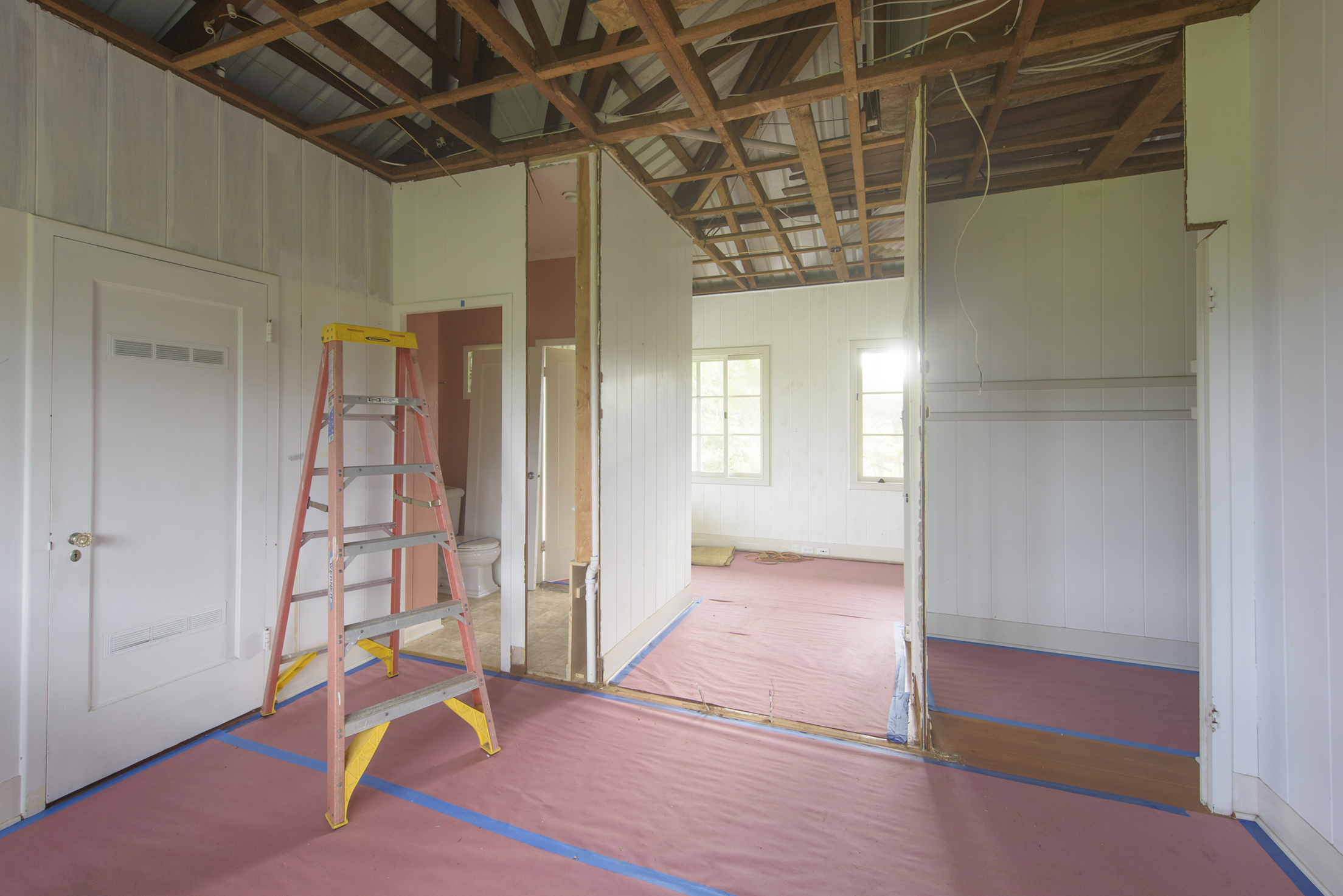

Maybe the image will be interesting. Notice the 1940s knob-and-tube wiring (in service for overhead lights until about a year ago) in the upper left. That's AC wiring coming up through the floor. You can also see the single-wall construction. Almost all the wood in this house, except for flooring and window frames/casements is redwood. Termites don't like it, a huge plus in Hawai'i.

Your structure looks like it has pretty solid bones. Just a thought - while much of it is daylighted, a lookover by a local inspector might be helpful in that he/she could offer some inexpensive wind-related upgrades? I'm often the client's rep in the field, so I'm like that in my train of thought...
Hurricane clips are on my list, at least for the exposed parts. Like the cabling, may as well do it while so much is exposed. New builds here now have to be wind-resistant. In Hawai'i we used to go decades between hurricanes. Now we see them -- or at least warnings -- regularly. This year we had two misses but they were worrisome. I've got to do hurricane shutters before next summer.
