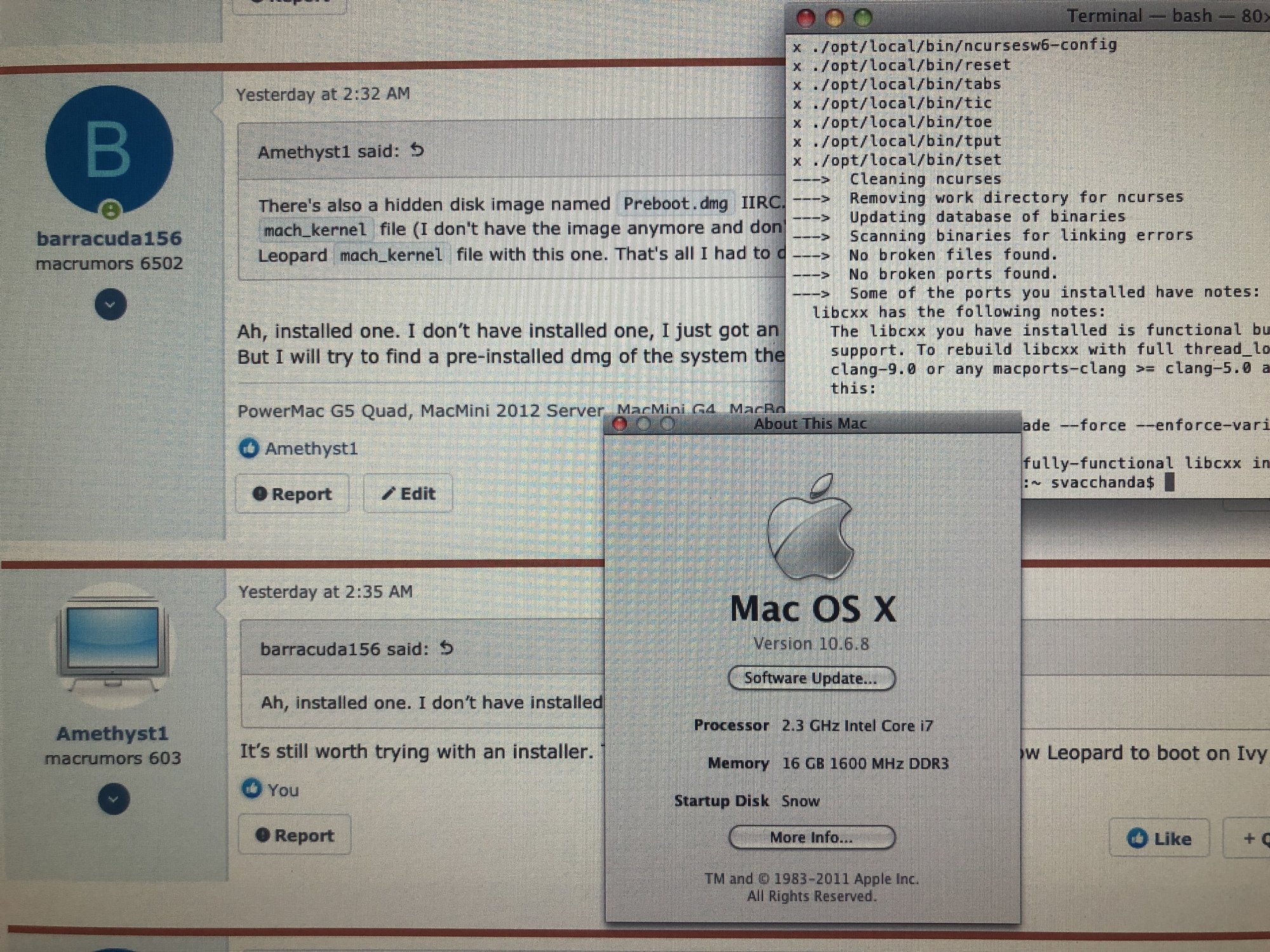

I got Snow Leopard booting on a Late 2012 Ivy Bridge Retina (!) MacBook Pro using just the patched kernel from the iBoot Ivy Bridge package. But that's about it. Virtually nothing works. I wouldn’t call this a success.

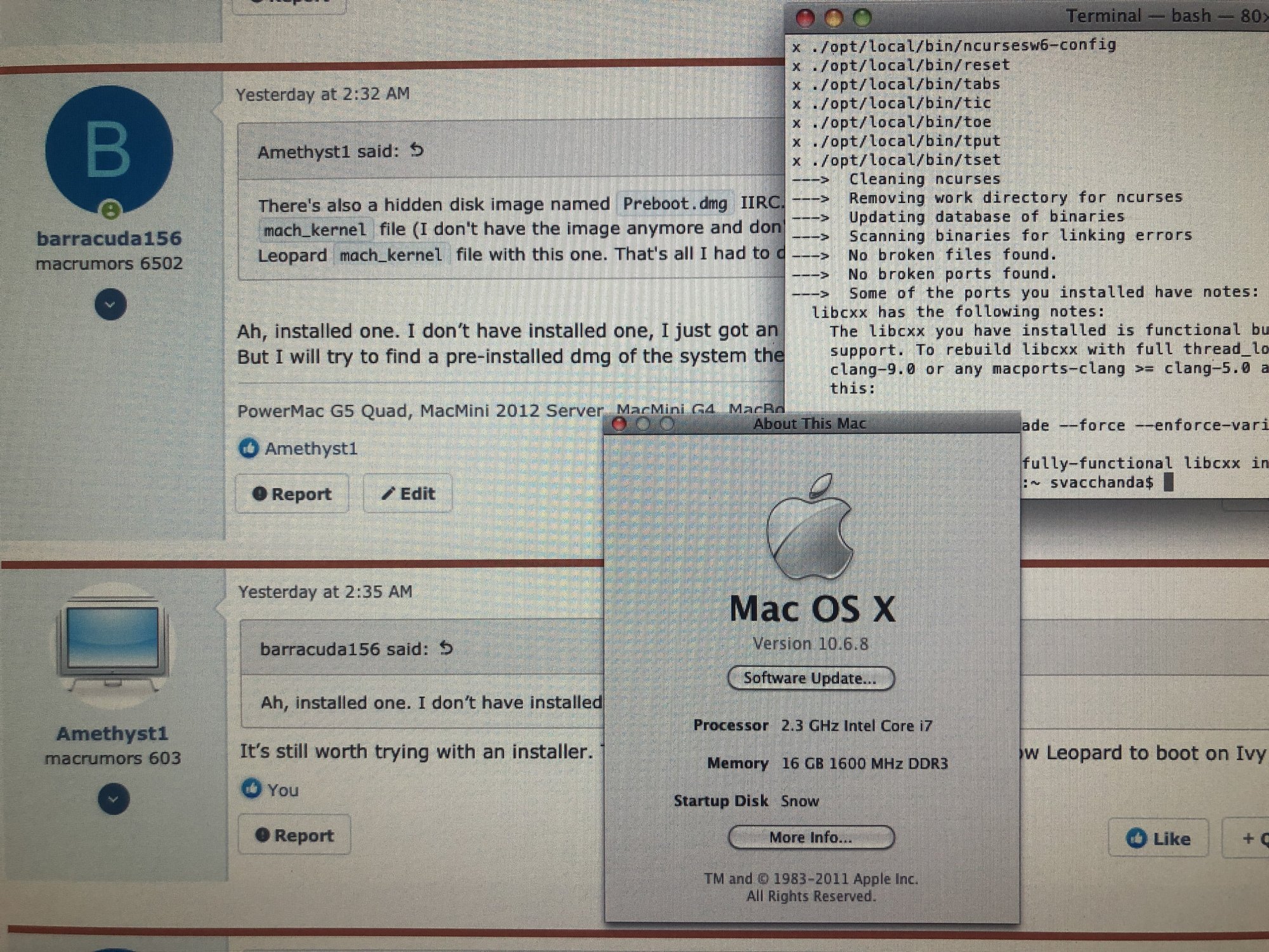

It actually seems to work. Some Apple apps fail though: iTunes does not start, Preview crashes, Image Capture works, but with bugs. Feels like 10.6 PowerPC LOL
But I don't care about all these, the only important part is compilation, and well, Xcode installs and apparently works, BBEdit works, command line works, I have just built Macports from source and installed a couple of ports.
Blutooth keyboard and Magic mouse work, but no touch scrolling. AirPort works. Arctic Fox browser works. Not too bad!
