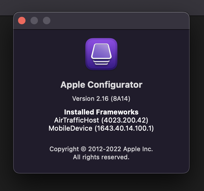

I used Apple Configurator Version 2.16 to restore the machine. Had no problems with it, neither last year, nor this time.

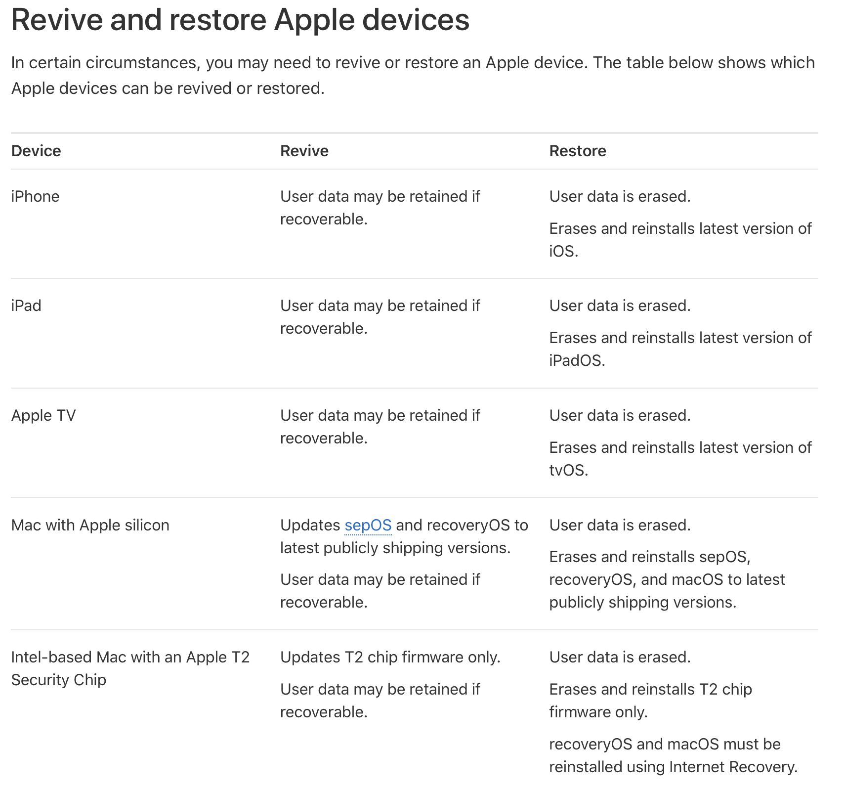

Did you mean in a system cache, since firmware is read only?
Restore with Apple Configurator, according to Apple:
User data is erased.
Erases and reinstalls T2 chip firmware only.
recoveryOS and macOS must be reinstalled using Internet Recovery
Apple Configurator - Apple Support

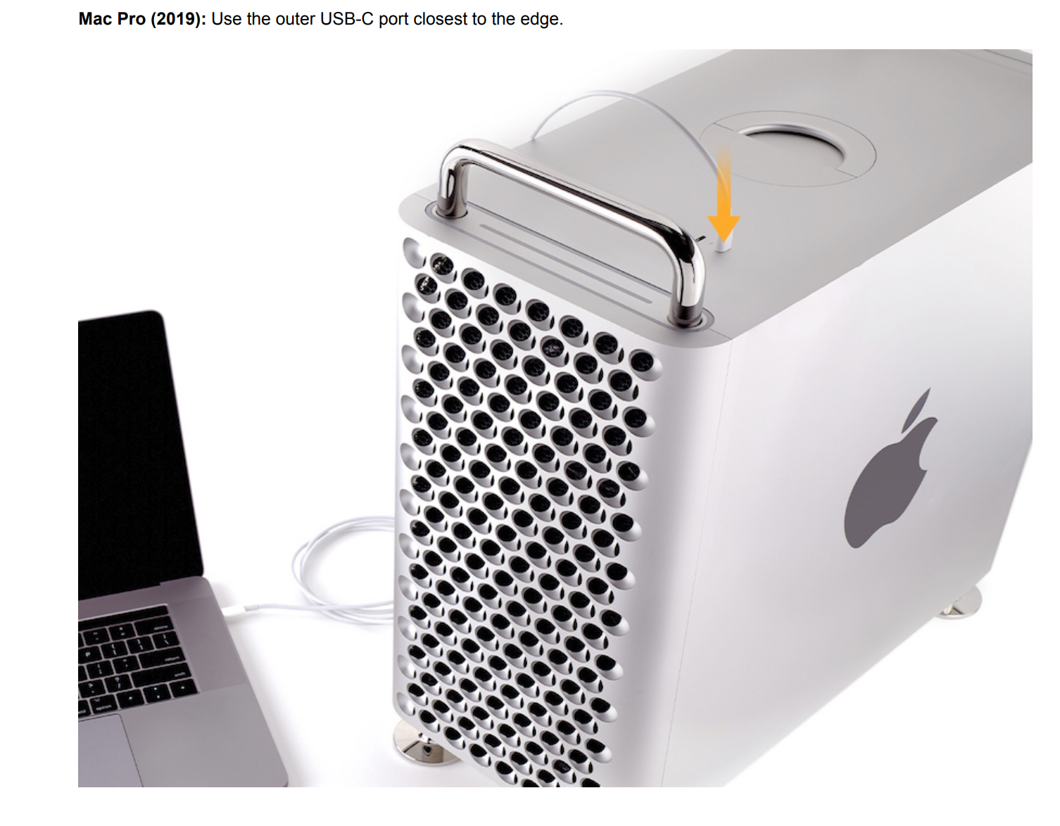

Interesting, when you configured the new SSD, did you plug the cable into the correct port?
Yes. The documentation clearly states that is the port to use, when restoring the machine in DFU mode.
