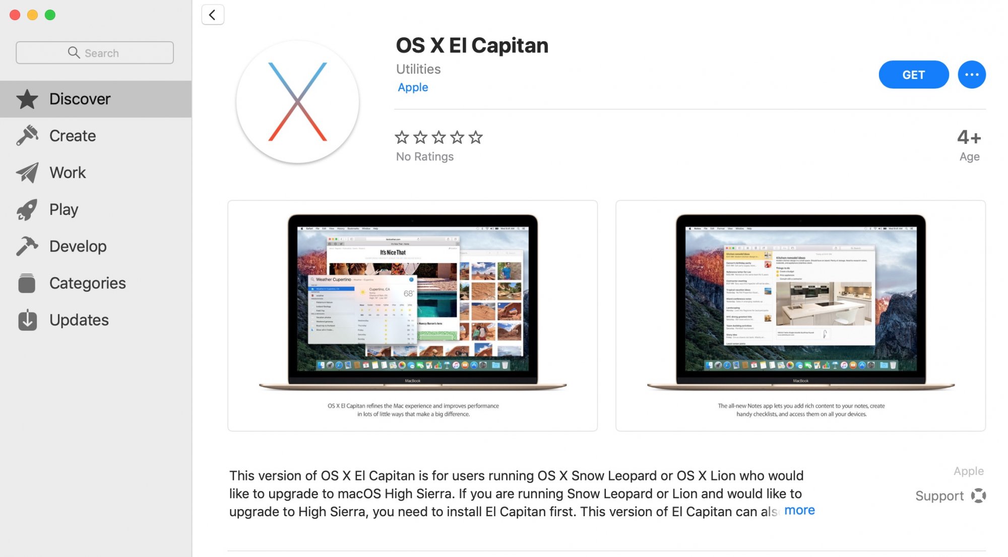

The Apple official way to get El Capitan is via this Apple Support page (see Steps 4-6):
here you go. Please don't feel I am challenging you, just sharing my experience.

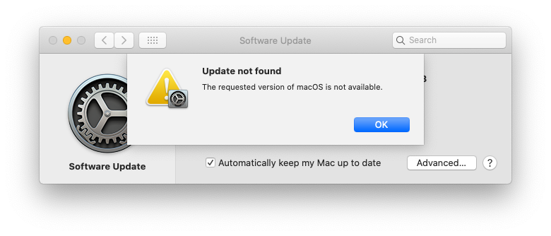

El Capitan is still available at the App Store, I saved the link from past access, but it is not the "official" Apple way to get it and the certificate may have expired:
Don't work here, I'll check from an earlier macOS release. Anyway, it's not the ProductID from the MAS version. Maybe it's the previous version of the Apple Support release that have the old certificates - that version could be used to create an createinstallmedia USB installer, the new one can't.

MAS URLs are country agnostic, it's not this. Some old macOS versions can't be downloaded from newer macOS releases, you have to use a previous one - maybe it's the case here.

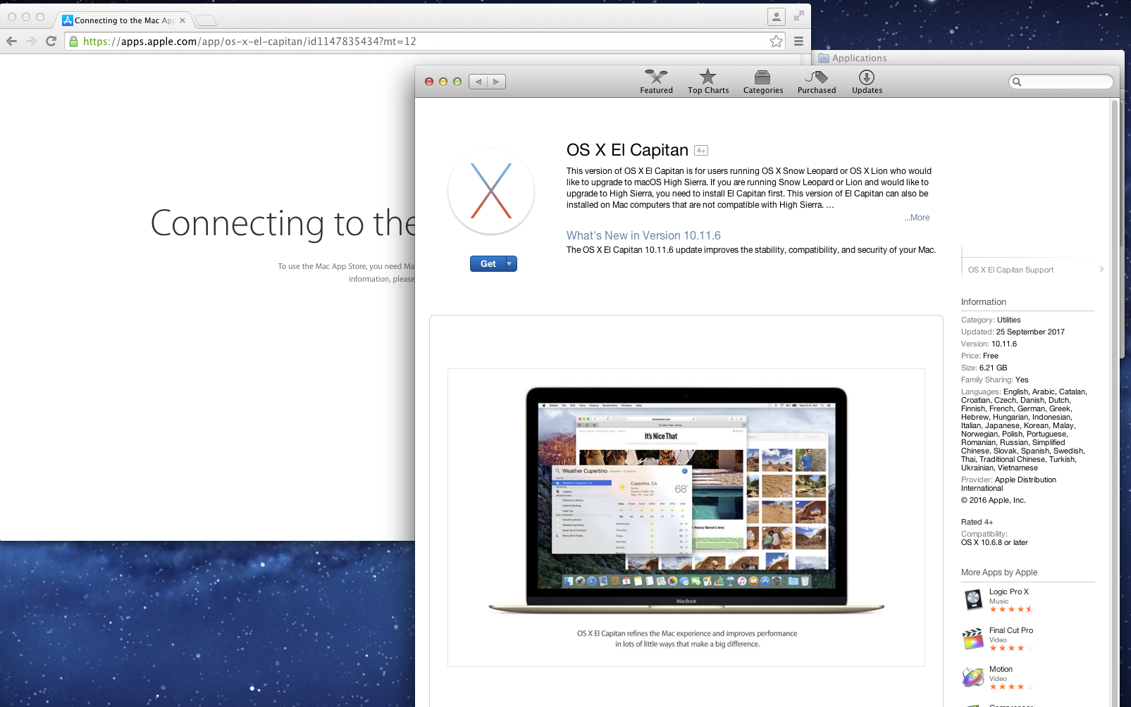

Works here. When I click on the link a web browser page opens and automatically connects to the App Store and I get access to El Capitan at the App Store (I'm currently using Mojave):
